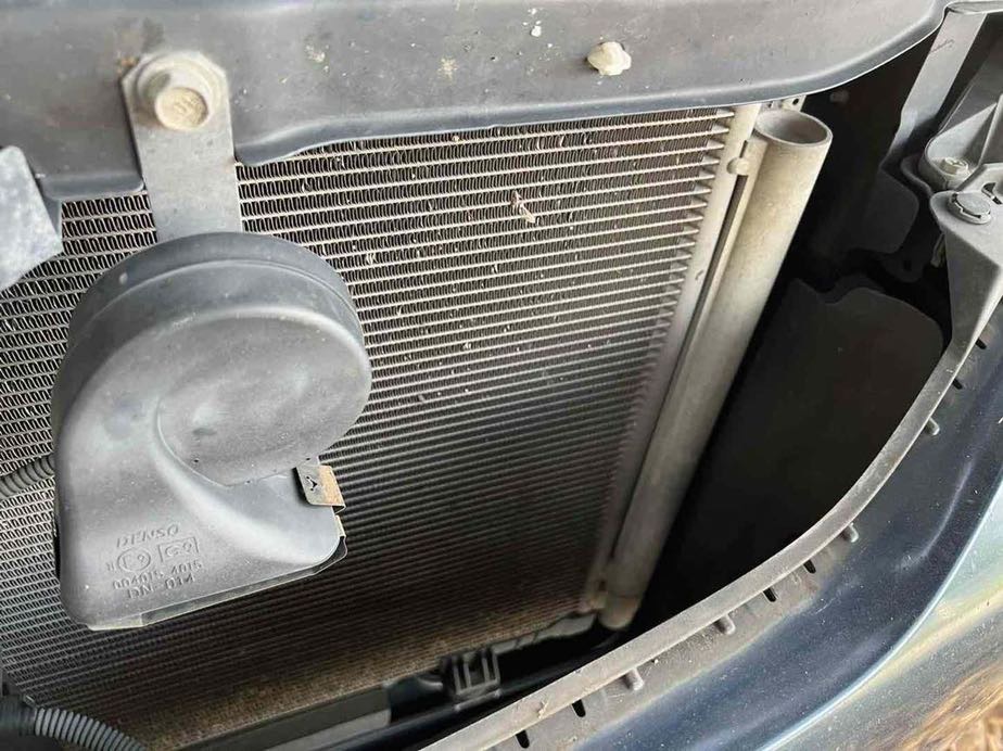

OK, we are having a terminology problem. Some pix would help enormously. Please send a pic of what you are calling an accumulator.
If there is anything AC related close to the firewall on the pass side send a pic of that also

Photo below of drier/accumulator built into right side of condenser.
attachment=0]485D4735-5100-44F5-9899-DC6BC8D94A14.jpeg[/attachment]

- 485D4735-5100-44F5-9899-DC6BC8D94A14.jpeg (185.56 KiB) Viewed 6420 times

I wondered about that as well. It sounds as though the OP didn't take into account the oil that was probably already in the condenser, R/D, evaporator, and lines.
