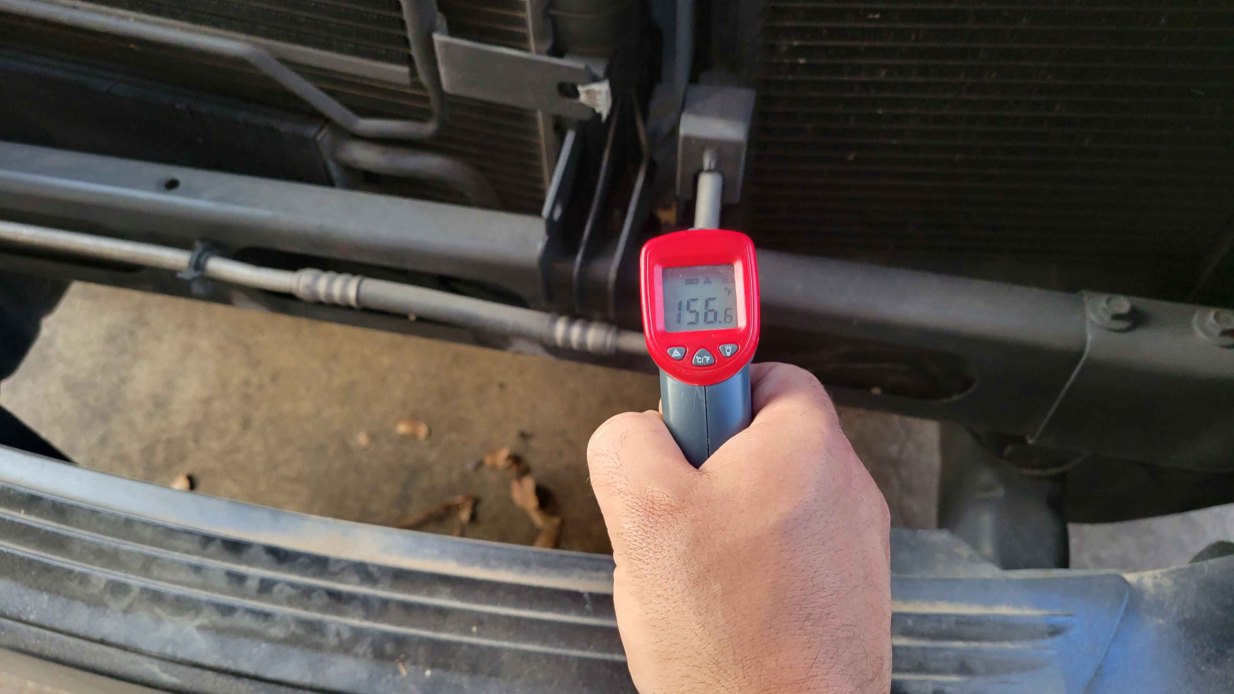

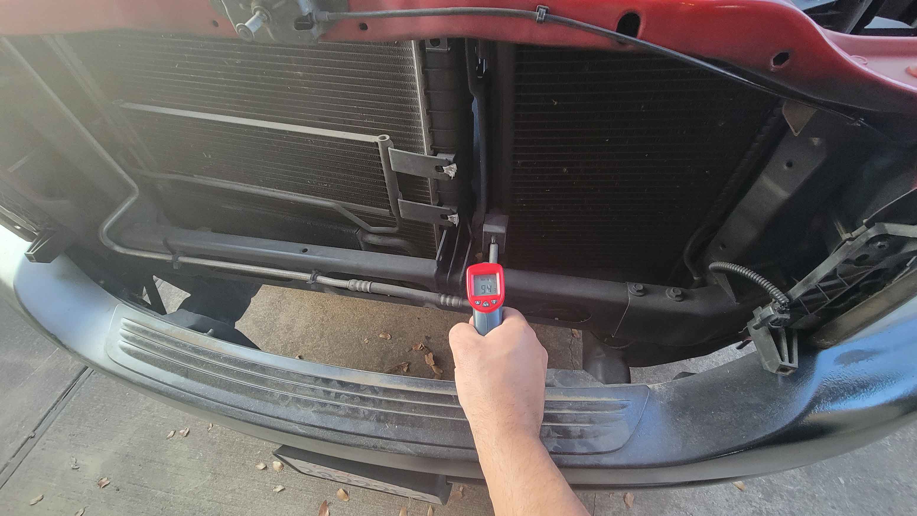

Attached are 2 photos. The 1st photo shows the condenser fan line (if i got the right one?) at 94 degrees when the car hasn't been tuned on all day and cold. The 2nd photo shows the condenser fan line at 156 degrees after the car was turned on for 2 minutes.
Does this seem right?

The line on which you're measuring the temperature looks to be the liquid line or the high-pressure line. It should be warm-to-hot while the A/C system is running.
Is that the same line the shop changed out? In fact, some OT's are crimped permanently in position, requiring that the entire line be replaced. I'd sure like to know whether an OT is present inside the line, but that would require recovering the system and disconnecting the line to verify.

No, the line I'm measuring is the lower condenser pipe.
DetroitAC said he thinks it's a clogged condenser filter and asked me if the very bottom of the condenser pipe gets cold. That's why I measured it before and after the car started. Is it supposed to get cold after the car starts and the AC runs for 2 minutes or is it supposed to get hot, like it did?

Getting the temp of the condenser line when the car is off will be of no value.
Once the car and AC has been running about 15 min,(max fan, max cool, rpm at 1500, doors open) (shoot) take the temp of the pipe into and the pipe out of the condenser and we can compare those 2 temps.
When you take the pix, see if you can include in the shot where the red dot from the IR gun is showing. In these other 2 pix it is hard to tell exactly what part you are shooting

Right. That pipe is the liquid line or high-pressure (HP) line coming from the condenser, according to the A/C line routing diagram that I have for your truck.
According to the same diagram, another liquid-line "extension," to which you refer, connects to the first line near the top of the radiator on the passenger side, which in turn connects to the evaporator inlet at the firewall. That entire two-piece HP line should be warm-to-hot up to wherever the OT is positioned. Just past the OT, the line should be cold. If it's hot all the way past the OT and into the evaporator, the OT is either missing or defective in some way.David wrote: Fri Jul 29, 2022 2:54 pm The liquid line is on top and near the firewall. It was completely replaced with a new one that already has an OT inside it.

For your reported condenser pressure of 400 psig +, yes it seems right, as in that is what your liquid line temperature should be for that much pressure. No, it's not right that you have that much pressure.
The condenser has it's own separate fan, it's on it's highest speed and running like hell when this is happening? I remember other AC development guys had one of these trucks with a fan set to run full speed all the time, sounded like it was trying to take off.
Good job checking that temperature, filter isn't the issue.
