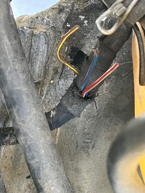

cut wires.jpg (106.75 KiB) Viewed 6808 times
Well I found the schemaic for the pressure switch and upon closer inspection I found the 3 cut wires. Now need to get or make a connector and determine which wire goes to which terminal.

erubin wrote: Tue Jul 05, 2022 1:56 pm Here is a view from beneath the car with missing RD. You can see some damaged metal with a few sloppy welds. Amazingly its the only sign of damage. The radiator support is perfect and factory original and the fender looks original with no paint overspray anywhere to be found. Its as though the damage only destroyed the RD and the car frame holding it.
Just guessing, but the damage could have been caused by the previous owner running over something on the road and kicking up in that one area, like a boulder, log, or even some kind of large metal part that fell off a truck or car. I suggest getting a four-wheel alignment done as well.
erubin wrote: Tue Jul 05, 2022 1:56 pm The second photo is taken from above. The electrical connector for the RD mounted temperature switch is intact but the RD mounted Blade type; 3-prong electrical connector is missing. I do se two sets of wires dangling in there, one is a green and a brown wire and the other severed wire pair is red/white and blue/brown stripped. Maybe I need to keep looking for the pressure switch 3-wire if it's not these?
Could be. Tracing them on the wiring schematic should lead you to the correct connection points.
