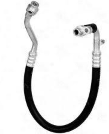

Is this the line you called about today? I was under the impression it was an all-alum.
This fits the 4cyl.
57-10695

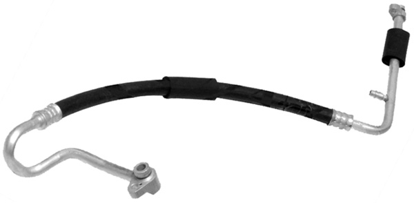

Posted: Wed Jun 01, 2022 7:11 pm
Is he looking for a discharge line? I had comp to evap.
Discharge Line 3.3L
57-0246
