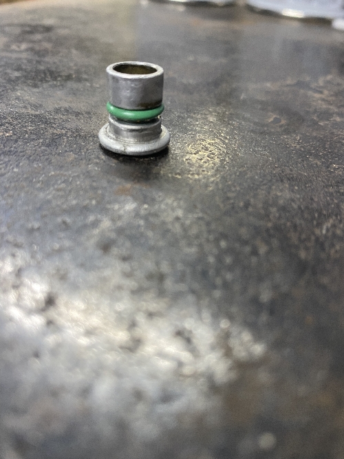

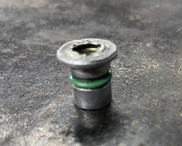

Well I found a kit with a fatter o-ring at NAPA and some sealer called “Leak Lock” at an HVAC store. When I took it apart the line broke. I called Nissan, I can get a new line for $250. If it’s even possible to install, it would take a lot of patience and maybe some luck. It goes up and thru the bulkhead, across the condenser, back into the engine bay, down to the frame rail, back close to the firewall and up again to the evaporator...one piece. The replacement may have a splice I don’t know. Is that the only alternative? Seems to me there’s got to be another way. Are there not hose ends where you could make a new line using high pressure steel braided flexible hose?

Your existing/now broken line had damage there, likely the cause of your leak, or would not have broken.

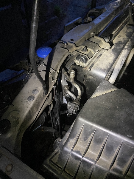

OK, I'm glad I can finally help the experts here because I believe I have the same truck (or quite similar). I have a 2004 Frontier 2.4 liter engine, 5-speed.tnfarmboy wrote: Tue May 31, 2022 6:43 pm When I took it apart the line broke. I called Nissan, I can get a new line for $250. If it’s even possible to install, it would take a lot of patience and maybe some luck. It goes up and thru the bulkhead, across the condenser, back into the engine bay, down to the frame rail, back close to the firewall and up again to the evaporator...one piece.
tnfarmboy - I feel that you are mistaken about your statement that I highlighted in red above. Replacement of the high pressure line from compressor to condenser does NOT involve that line across the top of the condenser at all. The fitting at the condenser end is "notched" at its bottom so just slips over the fitting that ends up going across the top of the condenser, so THAT horizontal tube does not get removed at all. The replacement line also shows that notch at that end of the fitting at the condenser, and attaches to the condenser with one bolt. The air duct (orange line) should be removed for better access by first removing two nuts with a 10mm socket (one shown, yellow circle)

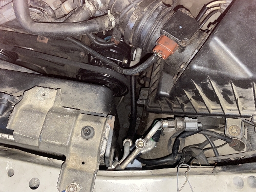

The notched fitting at the condenser can be seen here, see red arrow, so the lower line just stays in place.
The fitting at the compressor is a little more straightforward to access, also one bolt.
It looks to me like the Nissan part number may be 92490-1Z600 which I see under $90 at an online Nissan parts dealer (plus shipping) - so do NOT pay $250 !!!. But aftermarket part is available as well for less, call Tim and ask. So I hope this helps.

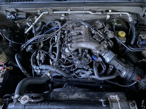

Mine is a 3.3 5 speed. I called ackits, he said he don't have it and can't make one. I'm going to call a local guy that makes hydraulic lines and see if he can do something. If that don't work out I'll see if I can get the old one out and back in. If so, I'll fork over the $250

Cusser wrote: Wed Jun 01, 2022 12:48 pm It looks to me like the Nissan part number may be 92490-1Z600 which I see under $90 at an online Nissan parts dealer (plus shipping) - so do NOT pay $250 !!!. But aftermarket part is available as well for less, call Tim and ask. So I hope this helps.
Oh, now you tell us: a 3.3 V6 engine. That looks like Nissan #92490-1Z610 Also under $90 at an online Nissan parts dealer (plus shipping). I see aftermarket for the 2004 VG33 V6 engine as low as $26.21 (with 54 available !!!) So if you pay $250, then that's YOUR problem !!!!tnfarmboy wrote: Wed Jun 01, 2022 6:16 pm Mine is a 3.3 5 speed. I called ackits, he said he don't have it and can't make one. I'm going to call a local guy that makes hydraulic lines and see if he can do something. If that don't work out I'll see if I can get the old one out and back in. If so, I'll fork over the $250
The fitting has a notch at the condenser for the V6 engine as well.

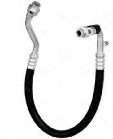

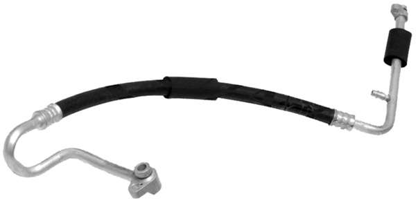

Is this the line you called about today? I was under the impression it was an all-alum.
This fits the 4cyl.
57-10695
This fits the 4cyl.
57-10695
