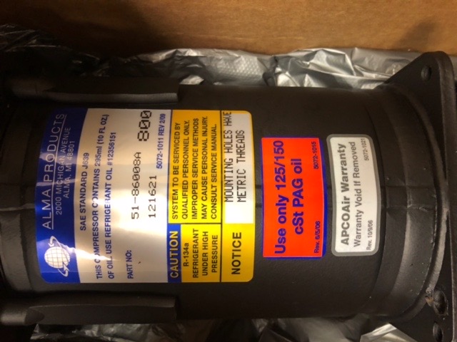

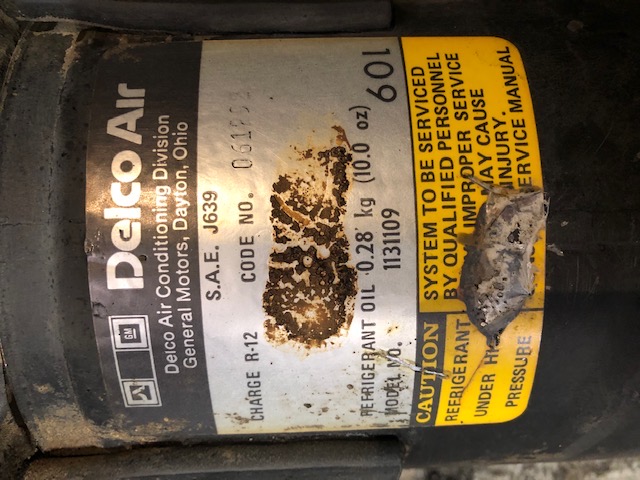

It says 10 fl. oz on the new compressor sticker label.
So if I am able to drain 10 oz PAG from the new compressor, I should refill with 10 oz mineral?
On my old compressor, it also says it contains 10 oz. See pictures.
So it doesn’t matter how much oil that’s being drained from the old compressor?
What about the new receiver drier, should I add any amount of oil to it?
Old compressor
Old compressor
New compressor
New compressor
Re: New A6 Compressor received with wrong oil type
Posted: Sat Apr 23, 2022 10:18 pm
jllgd wrote: Sat Apr 23, 2022 8:35 pm It says 10 fl. oz on the new compressor sticker label.
For all practical purposes, yes. Although a very small amount--maybe 1/4 of an ounce--of mineral oil will remain in the compressor after you flush it, putting in a full 10 ounces--perhap a 1/4-ounce over-fill at that point--won't make a difference.
jllgd wrote: Sat Apr 23, 2022 8:35 pm What about the new receiver drier, should I add any amount of oil to it?
Your option. You could put all the mineral oil into the compressor, which is probably what the factory did when the vehicle was built. Or put 9-1/2 ounces into the compressor and 1/2 ounce into the R/D.
