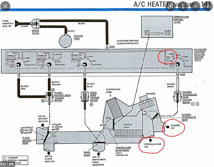

All vehicles I'm aware of have a provision for make-up/outside air. For that matter, all commercial buildings too.
Running in NORM on my vehicle prevents freezing of the evaporator due to the extra heat from outside air being transferred to the refrigerant. I can run the fan at medium or low speed in this mode without icing. On MAX and high fan, it gets uncomfortably cold in the cab not to mention the noise of the high fan speed. I can modulate temperature in cab by adding reheated air but this does not help with the fan noise.
