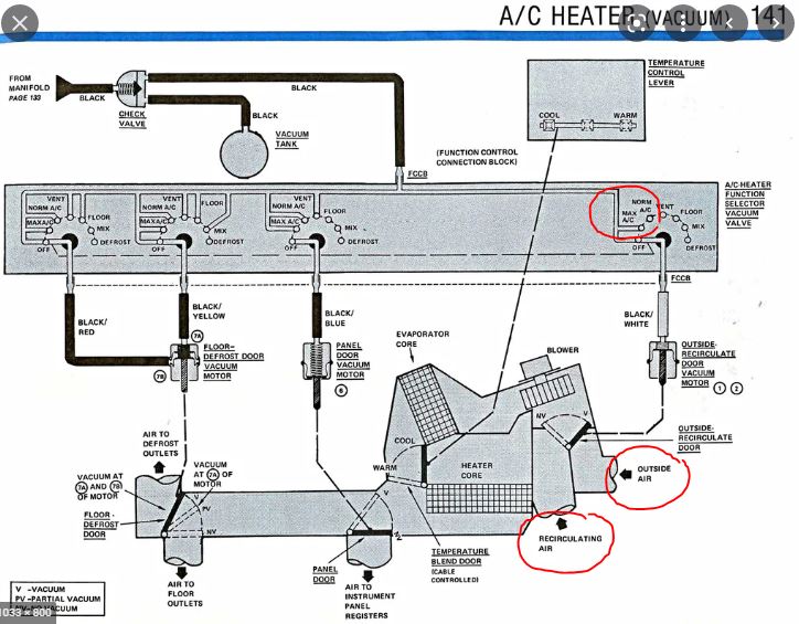

akaDigger wrote: Wed Sep 15, 2021 2:48 pm The 1986 Ford truck is now a R-12 to r134a conversion. I went to adjust the low pressure cut off because of freezing. The switch, seat of the pants adjusted down from 40psi, was too set low at about 20psi. I think I managed to sort that with the whacked gauge. IIRC, 25psi should be good there.
A 52oz R-12 fill originally, it now has 35oz of r134a. Also went with red tube versus the original blue. I had been waiting for milder weather. When I put the charge in it was 95°F outside.
Other info: All components are new except compressor. It is a dismantled and cleaned, resealed 1988 FS-6. The condenser is a serpentine replacing the OEM fin/tube.
All vehicles I'm aware of have a provision for make-up/outside air. For that matter, all commercial buildings too.
Running in NORM on my vehicle prevents freezing of the evaporator due to the extra heat from outside air being transferred to the refrigerant. I can run the fan at medium or low speed in this mode without icing. On MAX and high fan, it gets uncomfortably cold in the cab not to mention the noise of the high fan speed. I can modulate temperature in cab by adding reheated air but this does not help with the fan noise.
ac ford 2.JPG (89.39 KiB) Viewed 11132 times
