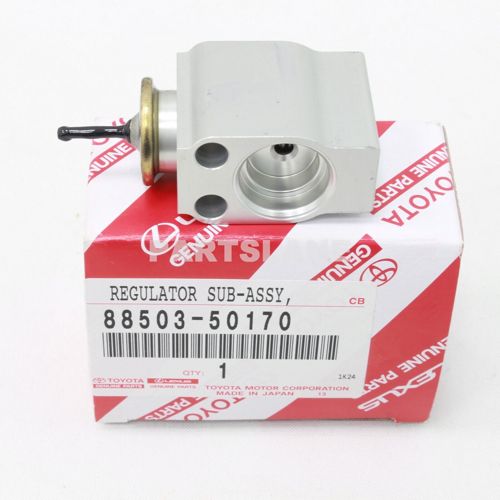

The "pressure regulator" mentioned earlier is a TXV bypass valve of some sort. It is a parallel branch from the liquid line to the evaporator inlet. It has a power head on it and a valve inside. I am attaching a picture. I still cannot honestly say after all the testing I did what the purpose of the valve is. I can only assume it acts like another TXV in parallel with the main one but for what purpose I don't know. Potentially it could provide an alternate path for refrigerant flow when the main TXV closes down due to very low pressure on the external equalizer line that senses between the EPR and the compressor inlet.
There are two inlets on the evaporator - one from the TXV and one from the "pressure regulator". I purchased a Four Seasons aftermarket evaporator and found that one of the two inlets, the one from the "pressure regulator" was blocked off and went nowhere. So somehow the system is able to operate with the "pressure regulator" unused/plugged with the aftermarket evaporator.
I changed the TXV from a 1.5ton externally equalized to a 2.0ton internally equalized. I figured the external equalization was to deal with the massive suction restriction that was the EPR, and that with the EPR removed was no longer needed. I was wrong. When I charged the system the low side would suck down to about 5-10 PSI and high side would refuse to come up above 130psi. I found that the plate/fin evaporator was enough of a pressure drop to cause the P2 pressure in the TXV to rise and close the valve. So I am switching back to an externally equalized TXV to overcome the pressure drop of the evaporator.
This pressure regulator device is still a head scratcher for me. I cannot figure out why this would be here nor can I find anything like it in any other Lexus or any other AC system in any car. I also found that the factory evaporator was very restrictive when deleting the "pressure regulator" circuit and just relying on the TXV. When I blocked it off the low side sucked down to almost 0psi and I found little temperature drop across the TXV but icing on one section of the evap. Apparently the internal passages in the evap are pretty restrictive and cant flow enough to fill the main section with liquid unless the "pressure regulator" is installed. The aftermarket evap circuit was different and didn't need the "pressure regulator" to flow properly.

Here is a picture of the "pressure regulator"
- s-l1600.jpg (202.37 KiB) Viewed 7995 times
