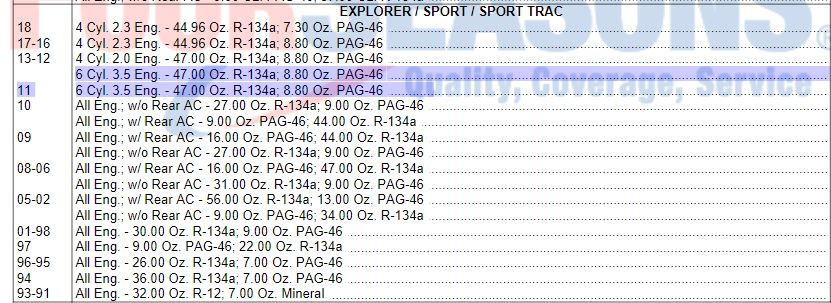

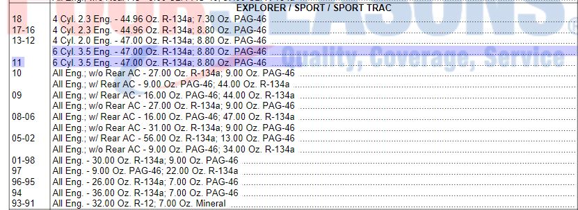

Yes U.S. but that chart is for trucks with rear A/C which this doesn't have.

Odd, no one lists 2015 with single air.
But follow the other's advice. You have some work to do before playing with charge levels.
