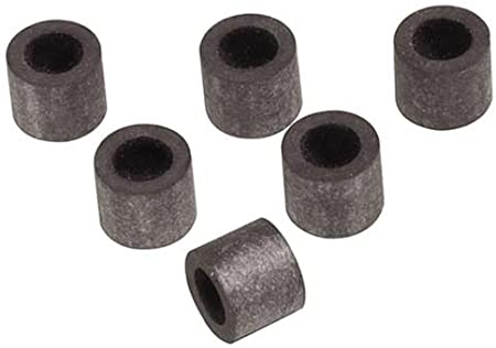

Inexpensive tools that do not work are the most expensive of all
These are the hose seals

just took one of the seals out and it pancaked at the top and its hard almost like plastic
i think it might be the problem

the seal is not 1/4'' like i see on napa
its an off size .301'' but the hose is 1/4'' i think
