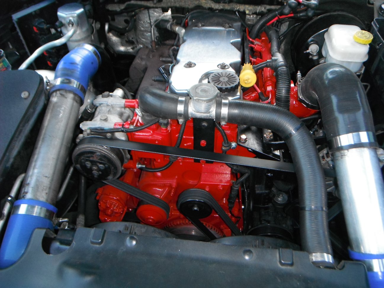

Meaning every single component is stock including the compressor? You adapted the comp to the Cummins?
Seems to be new info that this is an engine swap. I wondered how a Cummins got into a Dodge
How did you get the stock ECU to synch with the Cummins incl for the rest of the controls such as CPS, etc? That is always the hard part with swaps
Re: 08 Dakota / Cummins A/C help
Posted: Sat Jul 10, 2021 9:38 pm
by evguy1
Yes, just fabricated a mount for the Dakota compressor. Replicated the CPS on the front of the Cummins. The Dakota ECU is just a driver for the other modules and is not tied to the Cummins ECU. The Dakota ECU is "Happy" with no DTC's.
