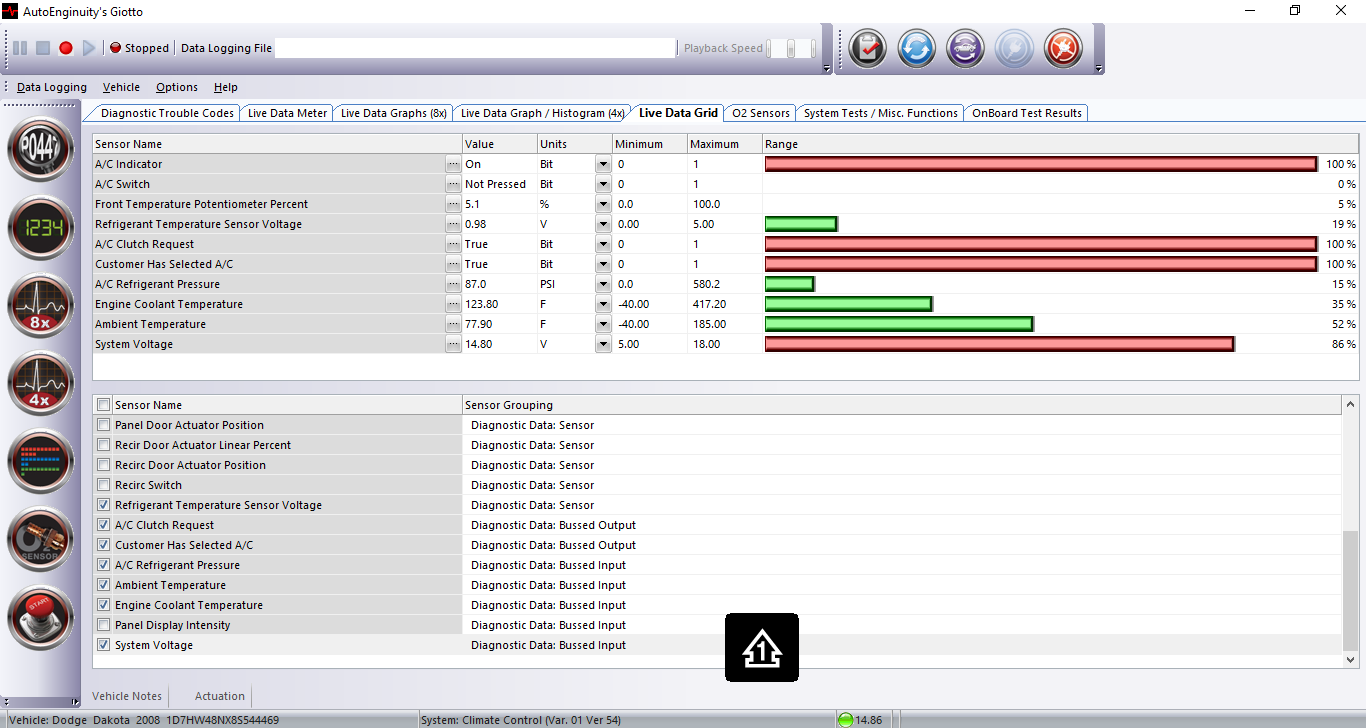

Just did a scan of the climate control module and it looks good.
- Climate control snip.PNG (176.89 KiB) Viewed 8487 times

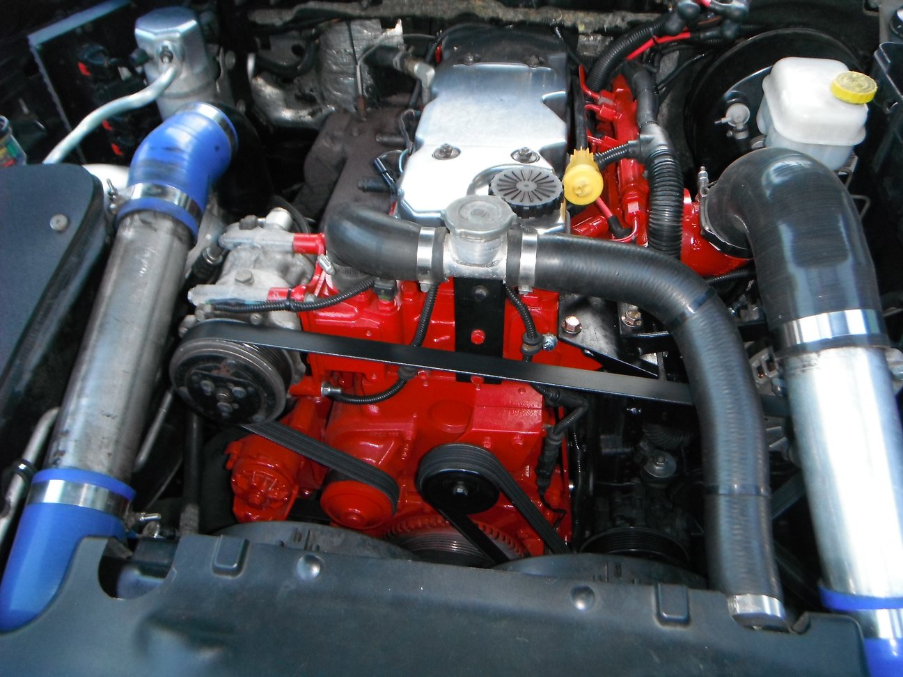

Meaning every single component is stock including the compressor? You adapted the comp to the Cummins?
Seems to be new info that this is an engine swap. I wondered how a Cummins got into a Dodge
How did you get the stock ECU to synch with the Cummins incl for the rest of the controls such as CPS, etc? That is always the hard part with swaps
Re: 08 Dakota / Cummins A/C help
Yes, just fabricated a mount for the Dakota compressor. Replicated the CPS on the front of the Cummins. The Dakota ECU is just a driver for the other modules and is not tied to the Cummins ECU. The Dakota ECU is "Happy" with no DTC's.

The engine has been amazing. This truck has towed our 20 foot fifth wheel all over North America for the last 7 years. Its not the old mechanical 4BT but the newer common rail ISB170. Lots of power and 22 MPG towing.
