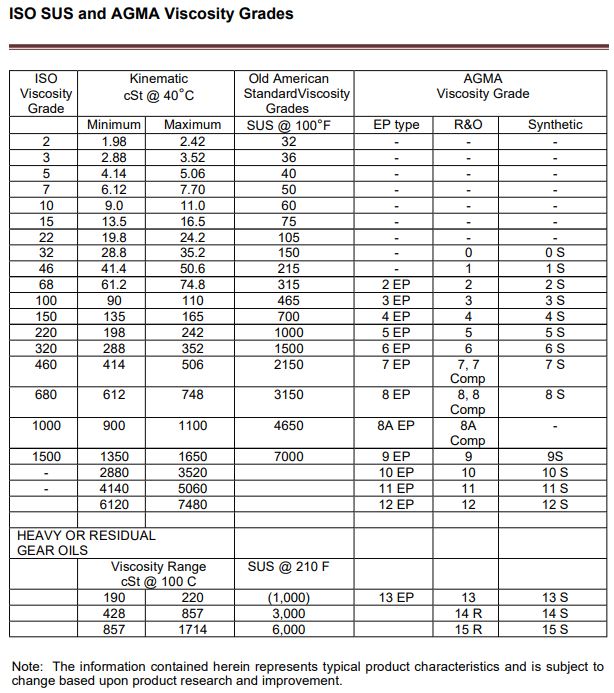

Sorry digger, grabbed the wron sheet this morning before coffee.
525 refers to SUS viscosity, which in ISO would be around 100.

by akaDigger
bohica2xo wrote: Wed Jul 07, 2021 9:04 am Sorry digger, grabbed the wron sheet this morning before coffee.
Bingo! A new search term that includes SUS.
