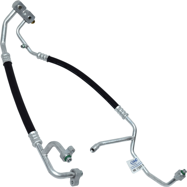

Re: 2008 Suburban vs 2000 Excursion AC Functionality
Posted: Tue Jun 29, 2021 7:56 am
hbabler wrote: Mon Jun 28, 2021 9:55 pm
Do you have manifold blocks for these in stock?
Like this or what type of block are you looking for. Besides being slightly different angles. I think the factory hose would match the rear ports.
35-12310
