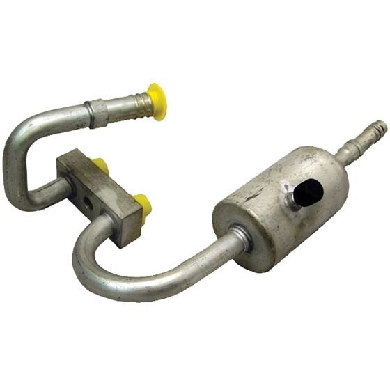

A messed-up muffler could be the reason I was seeing such weird readings on the high side (EDIT: Nope - see next post in the thread): No high pressure reading at all -- AND still seeing negative pressure on the high side when manifold pulled off compressor. I think I need to get rid of the muffler. What's the best way to do that without getting a new manifold connector?
Here's a stock photo of what this looks like

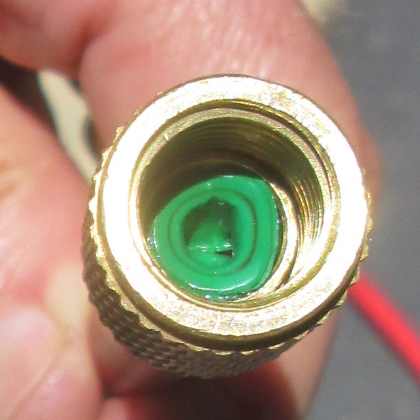

How about this messed-up red gauge hose fitting!! Yep, my false readings are caused by this. I ran some vacuum tests, shut it down, and any time I'd open this end, the gauge would drop to zero. Opening the fitting at the other end made no difference. This is a Autozone Loaner gauge set. Lesson learned.
Still doesn't explain why the compressor blew, or why all the oil was in the evap. One step at a time ....

Most of us service the seals on our hoses on a regular basis. I actually leave my fittings loose until I actually need them so as to not crush the seal to death
There has to be a way to have a new custom line made to eliminate that muffler.
Tim might have something like this available, just change the pad mount.

Keep the muffler. Just do something about the connector fitting. Why not pruchase your own manifold ? You will use it enough to make your money back.

Ahhh..."bubble gum" in the high-side hose fitting. That'll do it every time!
I agree with Doug. Why not invest in your own manifold gauge set? That way, you'll know what you have, that it hasn't been messed with, and you can maintain it yourself as needed. Purchase a good one, not a bargain set. It'll be well worth the money in the long run. I have three quality sets, so if one acts up for whatever reason, I can switch to another one. I check all the seals every time, and cap all the ends when not in use.

As for the hose, cut the muffler out, weld barb, and replace a section of hose.
Places like Cold Hose can do it. Best to find someone locally. Then there is buying the tools to do it which are not cheap.
