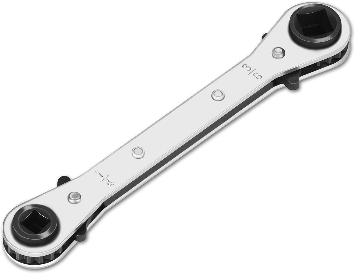

I liked the manual isolation valves; I installed that used compressor and only lost a tad of R-12. I used a 1/4-inch socket upside down, using a L-shaped allen wrench to turn the socket on the 1/4-ich square isolation valve stem. There were aluminum dust caps to protect the valve stems, but the caps did not have any sealing function.
Maybe something like this
Re: Compressor not holding vacuum
Posted: Thu Jun 03, 2021 4:01 pm
Yep, if a compressor had tube-o connections. You may see them used. Not just a York item.
Posted: Thu Jun 03, 2021 4:10 pm
yep, that is it. There is a "refrigeration wrench" with 4 ratcheting sizes with square holes for various sizes of stems.
Also works slick for using small size taps which always have a square shank
I worked on a '61 RollsRoyce once that had isolation valves on the York
