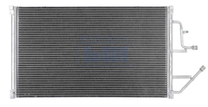

Is it the OEM Condenser?
Re: 95 Tahoe AC Overcharge?
Posted: Wed Jun 09, 2021 5:52 pm
by Caveman
Not sure. It was replaced 15 yrs ago ( deer antler), and I do not think it was OEM.
Posted: Wed Jun 09, 2021 7:38 pm
Are you inserting the OT into the liquid line side of the condenser, expect it to stop?
I don't have a condenser in front of me. But again, cond mount OT. Will be under pressure going back to the evap. So the stop point is going to be directed at the liquid line fitting.
Cond.
Liquid line
