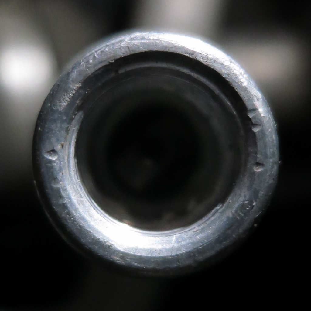

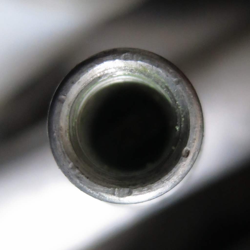

I took the below photos of the rims of the high and low side service ports in my VW GTI. I used my iPhone so the photo quality isn’t the greatest. However they show some nicks and dents on the rim. I'm thinking that perhaps these are preventing the o-ring in the cap from sealing properly.
If this is true, I’m not exactly sure how this would be fixed. Maybe sanding the nicks and dents down with emory paper would work. But it’s difficult to sand a rounded surface like these rims. So maybe sanding a flat surface around the top of the rim using a sanding block with the emory paper would work. This would give the o-ring a flat smooth surface to seal against. But the surface would also have to be level. So it could be difficult to do.
Another possibility might be to put Nylog Blue on the rim or the o-ring. Maybe it would fill in any nicks and dents and allow the o-ring to seal.
Another possibility might be to use the FreezeCap or A/C QuickCap devices that I saw mentioned elsewhere on this forum. These devices are supposed to provide a better seal than caps.
At the moment I’m leaning towards getting the FreezeCap devices and using Nylog Blue.

I took some better photos of the rims of the high and low side service ports in my VW GTI. See below.
Do you think the little nicks and dents in the rims are affecting the seal of the cap o-rings? If so, how would I fix the rims to get rid of the nicks and dents?
