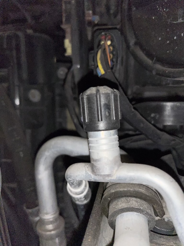

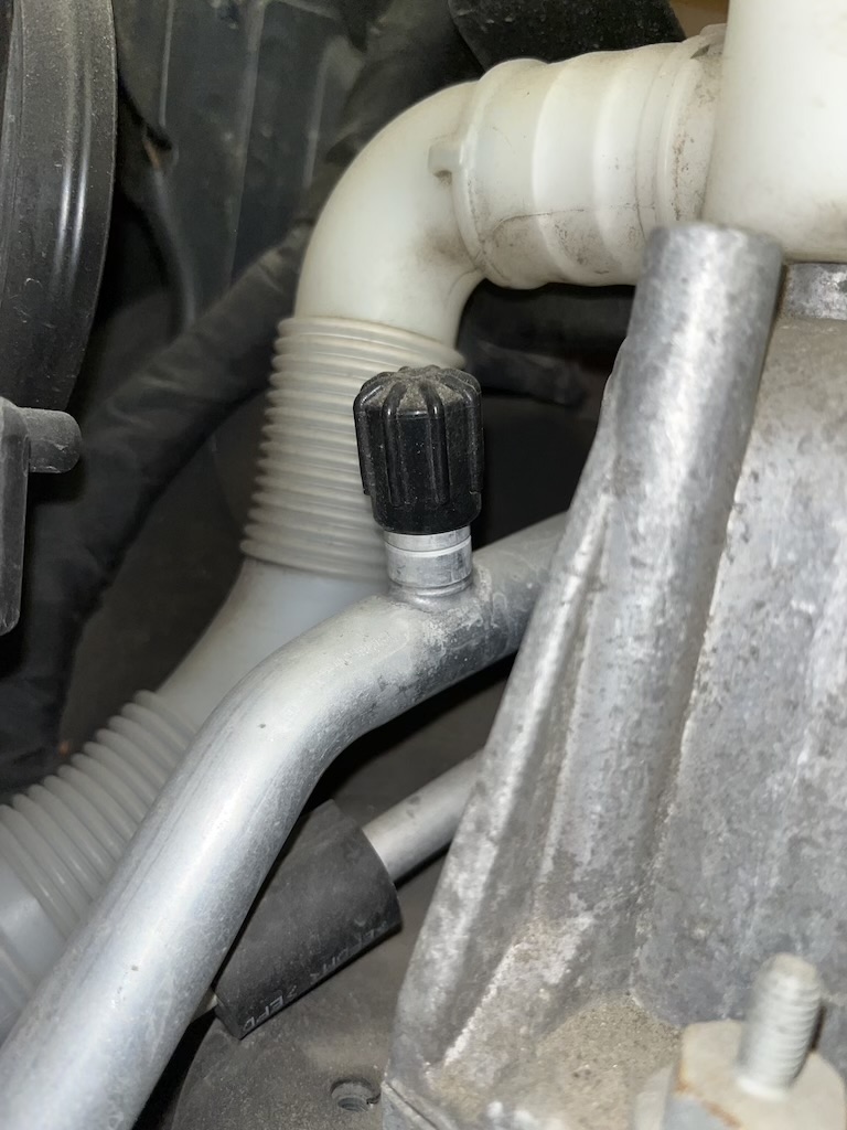

I’ve had a slow leak in the A/C system on my 2013 VW Golf GTI for over a decade. I bought the car in 2015 so it's likely leaked since it came from the factory. A couple years ago, after at least three previous attempts, a repair shop finally located the leak using soap bubbles, at least that’s what they told me. Apparently it was coming from one of the service ports. They said the Schrader valve is ok (they had replaced both), but the seat that the Schrader valve seals against at the bottom of the service port is defective so the leak is coming around the valve, not through the valve.
The pipe segment that the service port is attached to would have to be replaced to fix the defective seat, which would be very expensive. So to seal the leak they said they applied silicone to the service port cap threads. I thought this had fixed the leak. But two years later the A/C is barely working again, following the same pattern of the previous times the refrigerant leaked out.
Assuming the shop’s diagnosis was correct and the leak is coming around the Schrader valve, here are my questions:
From what I understand the service port cap is supposed to provide the primary seal at the service port and the Schrader valve is just used for sealing when filling and testing the system. So this means the service port cap is also defective and not sealing the service port correctly. Is this correct?
The factory service port caps are plastic (see attached photos). Should I get some generic aluminum service port caps that can be torqued down tighter than plastic caps in order to seal the service port?

Do NOT add any leak seal chemicals or refrigerant containing leak sealer/stop leak !!!!
I'd replace the schraeder valve and use a new good-quality cap after having the system re-charged by weight. I'd also look for other leaks as well. Note that there are different types of service caps for different manufacturers - silly but true !
I've had service caps which have had their rubber internal seal crack. The caps are the real seal of the refrigerant anyway, according to the experts here.

Re: 2013 VW Golf GTI A/C - Slow Leak
IMHO, the advice Cusser posted is 100-percent correct.
If you have the knowledge, skills, and tools to work on the system yourself, I suggest concentrating on potential leakage points first. Leaks could be anywhere, but I would focus my attention on the condenser, the compressor shaft seal, the area around the control valve, the compressor's belly, the condensate coming from the evaporator, and every joint to which you have access.
If you're located in the Rust Belt, I recommend closely examining any metal lines routed down low, as well as the bottom of the condenser, for pinholes.
I would also examine with a magnifying glass the service ports themselves and the areas in which they're welded onto the tubes. If you need replacement tube assemblies, they're available at reasonable prices. Check with Tim at ACKITS.com, this Forum's sponsor.
Nylog Blue is an excellent product and is compatible with all MVAC systems and components. I wouldn't use any other substances that might contaminate the A/C system.

I don’t think the shop that last worked on it added any leak sealer chemicals. Here’s exactly what they wrote on the invoice:Cusser wrote: Sat Sep 05, 2026 6:43 am Do NOT add any leak seal chemicals or refrigerant containing leak sealer/stop leak !!!!
- Customer concern A/C constantly needing to be topped up. Performed diagnosis. Found lowside Schrader valve to be leaking. Removed and replaced both Schrader valves. Tested, verified still leaking, looks like coming through threads. Removed Schrader valves, sealed with thread sealer. Re-installed Schrader valves. Re-charged A/C system. Tested and verified okay. Low side A/C line may need replacement if problem persists.
By “good quality cap” do you mean something other than a new OEM cap? Do you know of a brand that makes caps for VW or European cars?
Should I take the car to a dealership, a shop that specializes in VW cars, or try to find a shop that specializes in vehicle a/c repairs?
When it appeared to be out of refrigerant I did not turn the A/C system on out of concern that the compressor would be damaged. However, I usually drove a few thousand miles before I had it re-charged. Considering this and the fact that it ran out of refrigerant multiple times, is it likely that the compressor got damaged?
