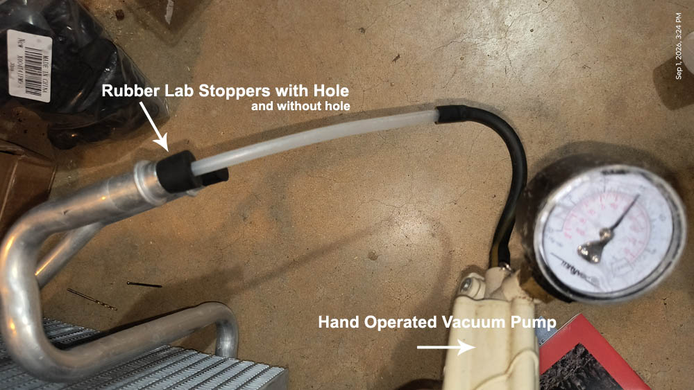

I maintain a personal inventory of Evap Cores, Condensers, heater cores and A/C hoses for my hobby of collecting and maintaining older Dodge Grand Caravans.
Every time I get a new one I used to wonder if it's got any leaks (Oh, I worry about the AC equipment as well :-).
installing it immediately on the vehicle can reveal leaks in time to return defective items, but still the work to install a defective (Leaking) Evap core, condenser etc just to remove it, send it back, get a replacement and do it all again is daunting. So here's how I test my cores and any part that is supposed to hold pressure (by testing vacuum) before I use it.
Vacuum is the standard method for testing AC systems for pressure right? (I could use positive pressure of course but the stoppers might pop out)
This is mainly for those new to Automotive AC since I'm sure the Pros here have their way of doing it. Probably better. But this is a really cheap way I test mine before shelving them for the future...or immediate use. Show us your setup (and a link to a massive discount coupon please lol)
They have these hand operated vacuum pumps for about $25.00 on Amazon

Thats a good idea. Never thought of using my brake bleeder

GMBDguy wrote: Wed Sep 16, 2026 12:37 pm Thats a good idea. Never thought of using my brake bleeder
Thanks. Works for me.
The one I use for AC testing was never used for any brake work. I wouldn't want to accidentally contaminate AC lines with brake fluid.
These vacuum pumps are cheap enough to afford one for this purpose fortunately.
