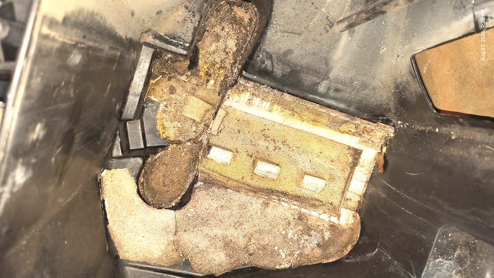

One of the more difficult tasks I'm facing is that the HVAC housing was manufactured with custom molded styrofoan insulation pieces in the bottom of the evap housing that have become brittle, dry rotted and basically are falling apart. I want to re-insulate that area but getting replacement styrofoam pieces is out of the question. Below is a photo of the failing styrofoam.
My first thought is to replace the strofoam with an improved coating of some sort. The housing is plastic so just about any coating would probably stick. Something that can survive hard cold and lots of time in a moist environment. There are too many compound curves to shape anything (as far as I know). There's got to be some brush on insulation coating that could be applied easily that would stick well and endure the conditions inside a plastic HVAC housing for a long time (10-15 years minimum?)
If I had to go with a sheet of something, Adhesive backed Neoprene comes to mind but I'm not sure if that would stay stuck.
It has to be NON-Expanding foam or at least limited to approx 1/8 expansion.
Anyone know of a product for just this use or have any suggestions?

Option 1: I've never tried either option, but how about spray-on foam-in-a-can, the inexpensive type from your local home center that's designed specifically for sealing around windows? Unlike expanding foam that will fill gaps one inch or wider, the window variety features minimal to no expansion, but I'm unsure how it would stand up to moisture. I would go to the store and read the label carefully, or contact the company directly.
Option 2: PUR Black Foam (BF01) is used in Water Gardens and Water Features, so I know it's waterproof. However, I'm unsure how it would work for your application. It's fairly expensive last I checked, and it requires a Pageris Gun (sold separately) to apply the foam. Unlike Option 1, I believe it's the expanding type of foam.
Other than those, I'm not aware of any other products that might be suitable.

Thank you Mr. JohnHere!JohnHere wrote: Sat Aug 29, 2026 1:52 pm Option 1: I've never tried either option, but how about spray-on foam-in-a-can, the inexpensive type from your local home center that's designed specifically for sealing around windows? Unlike expanding foam that will fill gaps one inch or wider, the window variety features minimal to no expansion, but I'm unsure how it would stand up to moisture. I would go to the store and read the label carefully, or contact the company directly.
Your suggestion may be the one.
While researching Black Pur Foam, I found Black Straw Foam which is the same product in a pressurized can for low volume work. That might be perfect for what I'm doing. It expands a bit more but I have a solution. It appears to have the same or slightly better R Insulation value as Styrofoam.
https://a.co/d/02gxcch9
I'm thinking of carefully cleaning the area I need insulated , then applying a Wax layer to provide a non stick surface. Next I'll fill the area I need insulated with a hardening liquid (maybe epoxy) to create a reverse mold. Afterwards I'll thoroughly clean the wax out then apply the Straw (or PUR) foam and use the mold I made (wax coated) to press the foam into the exact shape and thickness I need. To do this I'll drill several tiny holes in the mold and using a marked tooth pick as I press it in to stop when I reach the right depth of approx 1/8 inch.
If it sounds like a lot of work for little results, I have a number of older Dodge Caravans that will likely need this done when I next change their evap cores and part of my reason is that I always like to make things better when I re-do them than they were to start with. Restoration. I really like my older grand Caravans. Hobby.

If anyone ever wants to do this resto on their vehicle HVAC housing, I found a much better way via a smart guy who does this type of thing a lot. He suggested Mann Ease Release. It's sold on Amazon etc. It's a spray specifically made to spray on and release hardened epoxy resins.
This is gonna make this job SO much simpler.

The process you described earlier, plus the addition of Ease Release, sounds very promising. The only potential issue I can see is maintaining the PUR foam to a uniform thickness due to its expansion properties. I suggest doing a trial run on a disposable substrate first.
Let us know how it goes.
