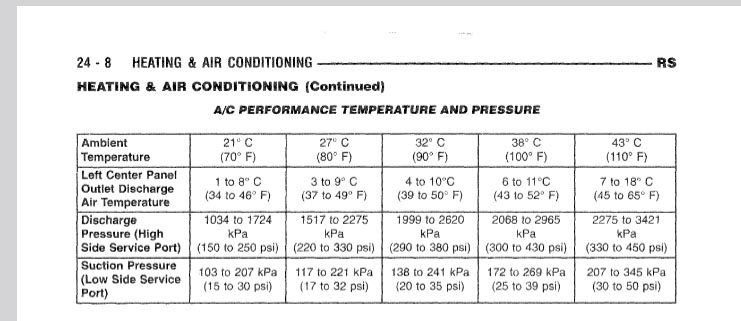

Pressures are good when running - 35psi and 290psi (good according to the Factory Service Manual) at the ambient outside temp of 96F. When not running, pressures are right at outside ambient.

Contrary to the Factory Service Manual, elevated pressure on the high side usually indicates a condensing issue. At a 96°F ambient temperature, the high side should be ~225 PSI with decent condensing.

Hello JohnHere!JohnHere wrote: Wed Aug 19, 2026 7:04 am Contrary to the Factory Service Manual, elevated pressure on the high side usually indicates a condensing issue. At a 96°F ambient temperature, the high side should be ~225 PSI with decent condensing.
Do you happen to know whether the condenser and fan(s) have ever been replaced?
As far as I can tell neither has been replaced. But they both look good and the fans seem to operate properly.
I personally find it stunning that the FSM would publish erroneous information on the vehicles they built.
According to their information, 225psi would correlate to an ambient of closer to 80F ?
The FSM figures are also for R134a which is what I am using in it.
Would you mind telling me how you came up with your ~225 psi figure?

Decades of experienceDiametric wrote: Wed Aug 19, 2026 7:39 am I personally find it stunning that the FSM would publish erroneous information on the vehicles they built.
But seriously, MVAC techs generally don't use pressure/temperature charts as they can sometimes be misleading.
One way to judge whether the high-side system pressures are "in the ballpark," so to speak, are by using the following multipliers. These multipliers reportedly say that the high-side pressures should be somewhere in the area of 2.2 to 2.5 times the ambient temperature.
For instance, the ambient temperature at your location is 96°F, so 2.2x96=211 PSI; 2.3x96=220 PSI; 2.4x96=230 PSI; and 2.5x96=240 PSI. Presuming that these multipliers are valid, we could say that the acceptable high-side pressures range from 211 PSI to 240 PSI, which sound reasonable based on the condensing factor.
However, it's a given technician's judgement call. I tend to be conservative when it comes to system pressures, so I said ~225 PSI with decent condensing. The decided-on high-side pressure range can and does fluctuate, as indicated by (~), depending on whether the condenser is unplugged or partially plugged with internal debris, whether something is compromising airflow through the condenser core, whether the system has a serpentine or parallel-flow condenser, and of course the ambient temperature.
