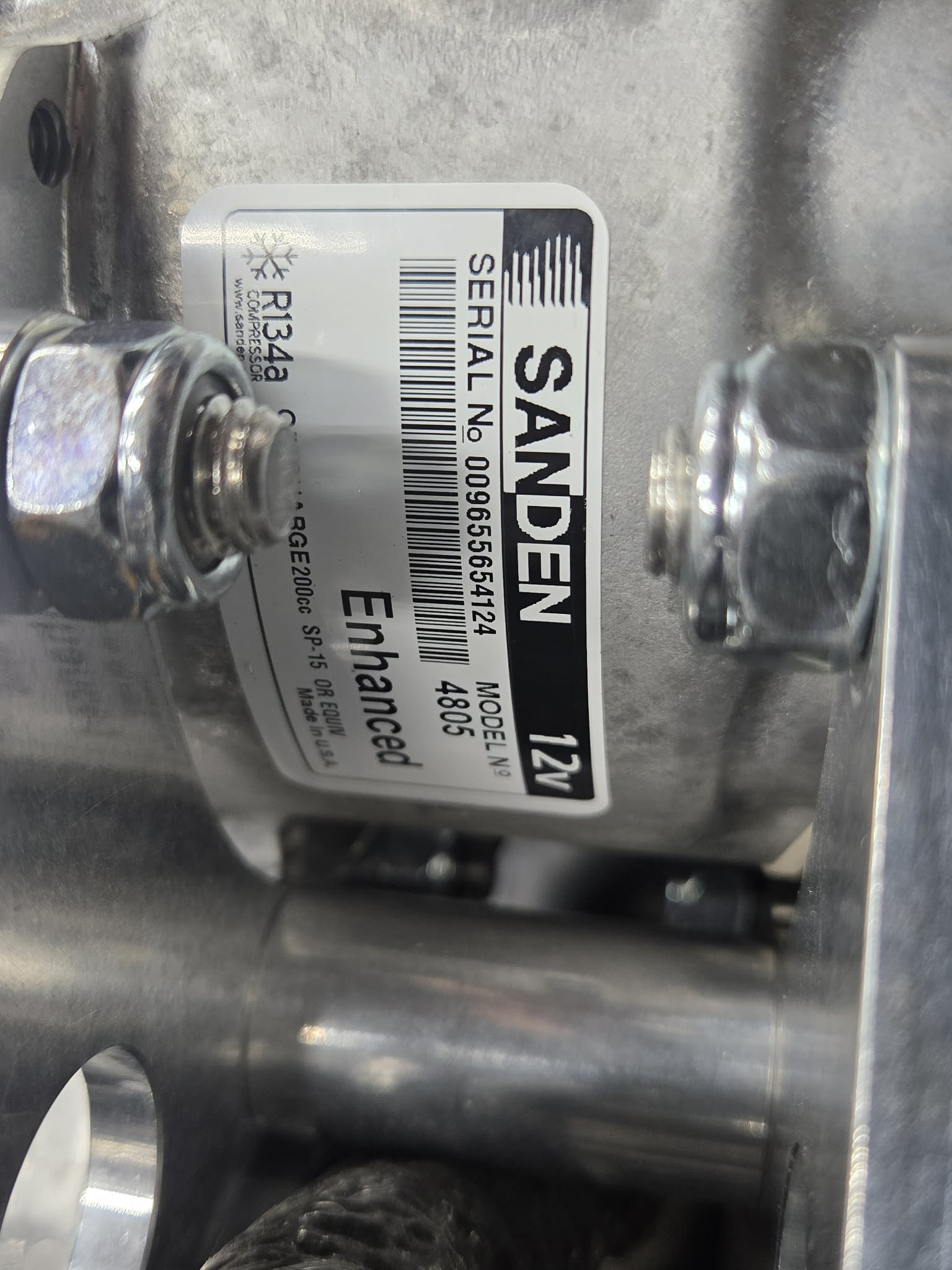

After suffering another R4 failure in less than 3,000 miles I decided to convert to a Sanden SD7H15 (4805) and 134a refrigerant.

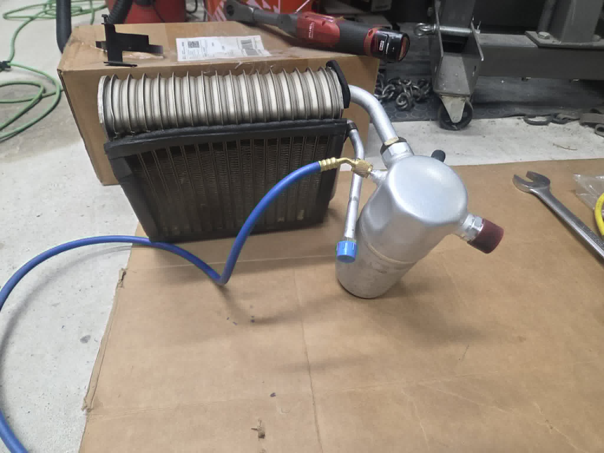

I have a new parallel flow condenser, and new stock accumulator and orifice tube. The evaporator was NOS when installed in 2020...I flushed it thoroughly and vacuumed it down for 3 hours to make sure all of the chemical was out of it.

The compressor calls for 200cc (about 6.7 ounces) on the tag.

I plan on emptying and measuring what is in the compressor and replacing it with fresh PAG SP15.
Would 6.7 ounces be enough for the entire system or should I be adding addition oil to each component?

Always a best est when mixing and matching parts. Evap is the only "larger" item from a universal system, which takes about 7 ounces.
