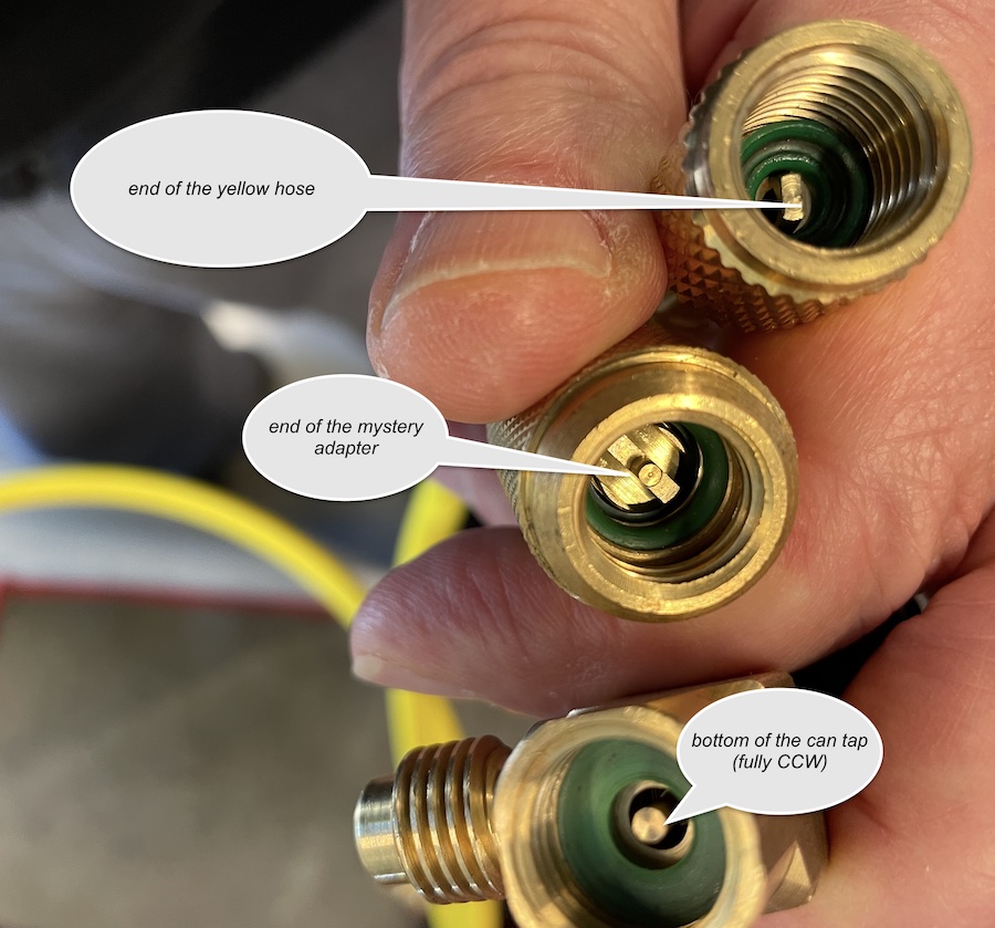

I cannot seem to get a tap that will work with the newer cans of R134A. I had the tap with the point (for the older cans), I bought a new tap that has a flat spike................. I also bought an "adapter" (blue plastic screws on the can), I tried both taps with the plastic adapter
I can't seem to get the R-134A to flow out of the can into the yellow hose on my gauge set. I tried a couple of different (new cans of R-134A) with the same results
Problem tapping cans of R-134A

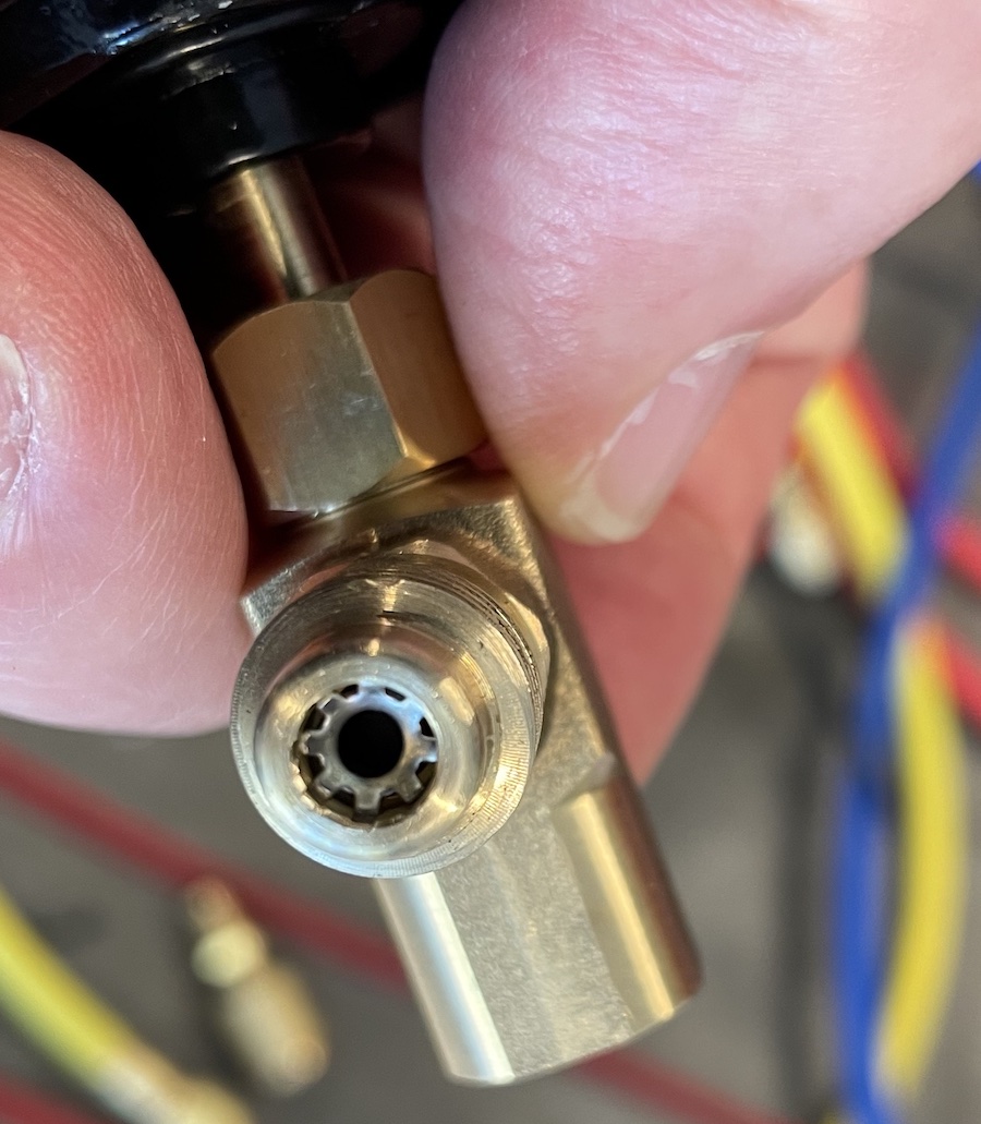

I have been fighting this too. I had a T-handled can tap for the newer cans that I returned because it apparently requires some kind of dance of all the way in, part way out. I replaced it with a thumbwheel can tap wit a blunt end and what appears to be a star-shaped valve to point toward the yellow hose. Then my yellow hose has a somewhat blunt thing sticking out but then I also have a adapter that goes on the end of the yellow hose (?) and has a pin for that star shaped valve?
In any event, all I can get is a little gas, very few ounces and a ton of frustration.
- can tap valve.jpg (236.39 KiB) Viewed 24480 times
- all ends.jpg (207.64 KiB) Viewed 24480 times

OP, if you have a newer can tap with a flat pin (not sharply pointed) inside, then screw it directly onto the can without the plastic adapter, which isn't needed in this instance.
Re: Problem tapping cans of R-134A
OK, what y’all need to recognize is that the newer cans of 134 with that crazy top fitting gives everyone trouble. What you need to do is get yourself a side tapper tool and forget those crazy tops. Use the side tapper at the top. If you want vapor hold the can upright, upside down if you want liquid 134. Have a better day!!!
You can get this tool from Tim here at ackits.com
