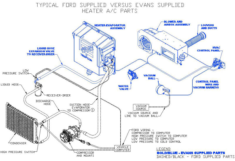

I wouldn't be satisfied with a vent temperature like that, which won't cool the large cabin of your motorhome much at all. Given the LS pressures you posted, the evaporator has to be ice cold, so 60°F vent air doesn't make sense to me unless the evaporator is just too small for the heat load.
Are you sure something else isn't going on, like heated air mixing in with the cooled air?
Re: Class A AC woes - bad expansion valve??
John,
Funny you should bring up the possibility of heat mixing with the AC...it appears that this is not an uncommon problem with these motorhomes. The water valve is electric, but I'm not sure how to test it. Someone mentioned trying to clamp it off to see if the vent temps get colder. I tried but I'm not sure if I did it right.
The diagram attached below is a typical Ford/Evans setup - the water valve is right in the middle of the diagram.
