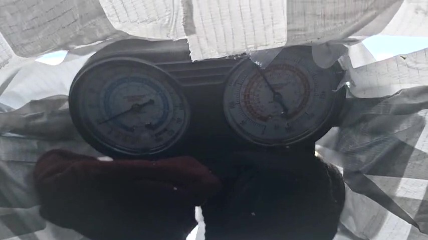

Seems to cool great at an idle and when you start it from a cool garage, but you drive and it starts to cycle very often. It'll also cycle when heatsoaked on a hot day. I taped my gauges to the windshield and went for a drive. On a 90F humid day while cruising the low side will go down to 8psi for a few seconds and cycle off. It'll come back on after 5-10 seconds. The high side seems to be fine at around 200-225. This is repeatable for the entire drive.
I set it to outside air and rolled the windows down and raised the idle. Low side this time was hanging out around 20-30 but the high side absolutely skyrocketed to 350-400. It never shut off while I did this for a minute, but I'm assuming it's hitting the high pressure cutoff on the hottest heatsoaked days because it does cycle off when I leave work until it cools down for a bit.
Am I correct in assuming a low low-side and high high-side and erratic cycling behavior will be a stuck closed or clogged TXV? It's a few hours up under the dash so I want to be sure lol.
Video of the AC running very well while we drove but the high side is climbing to 300 ish. The low side seems to hang out at around 16-18 psi: https://youtu.be/lMM0EqlMUAI

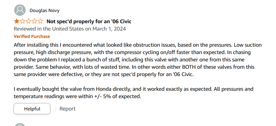

So I found someone with the same exact problem I'm having while shopping around. And apparently there's a different expansion valve for the coupe and the sedan. My crackpot theory is these aftermarket suppliers are calling the coupe and sedan valves the same and shipping the sedan part. Although my Denso part was specifically for the coupe and came from Rockauto. I don't want to waste my time again under the dash so I'm going to order a Genuine Honda TXV from the dealer and be done with it. I'll report back in a few weeks I suppose. I'm sure there may be others with this problem and this could help if it fixes it.

I've had similar problems in the past, but with aftermarket TXV's. After changing-out apparently defective parts several times—wasting time—I now stay with OEM TXV's, when available, and never had to replace any of them.
In your case, I can understand how a supplier could make that mistake: Both TXV's look the same, came from the same manufacturer, probably in similar looking boxes, but are calibrated differently. Key difference.
Re: 2008 Civic EX. Low low side, high high side. Cycling too much
Depends on the after-market supplier. We show a different valve for each.

The Genuine Honda expansion valve worked. I think I'm done with this rebuild once and for all. I reused the condenser and receiver drier again and charged 16 ounces.
I was getting 200 psi at an idle on a 94F day, 92F measured at the bumper. For some reason my gauges weren't reading the low side properly so I couldn't get a reading unless I was pushing down on the connector. It was hanging out in the 30-40 psi range.
I was seeing 48F at the center vent while idling and closer to 44F while driving. This was with the car closed up and on recirc since Florida's temperature and humidity is insane. I didn't tape the gauges to the car again but I did notice it's not short cycling on me at all anymore.
