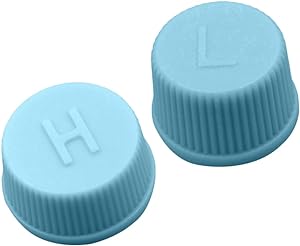

The CR-V is 20 years old and I'm considering replacing the service caps. Do the cap seals fail with age? I can't find High and Low pressure caps online that fit the Honda. The Honda dealer only carries the High pressure cap as the Low pressure cap has been discontinued. The caps look similar to those in the photo below.
I've read contradictory information regarding the function of these caps. Some folks online state that the cap is the primary seal and help keep refrigerant from leaking from the AC system, with the Shrader valve being the secondary seal. Others say the caps function to prevent dirt, etc from contaminating the Schrader valve and that it's the valve that seals the system. I hope one of you can answer this.
1. If the caps are critical, does anyone know a source where I can purchase the caps for a 2005 Honday CR-V?

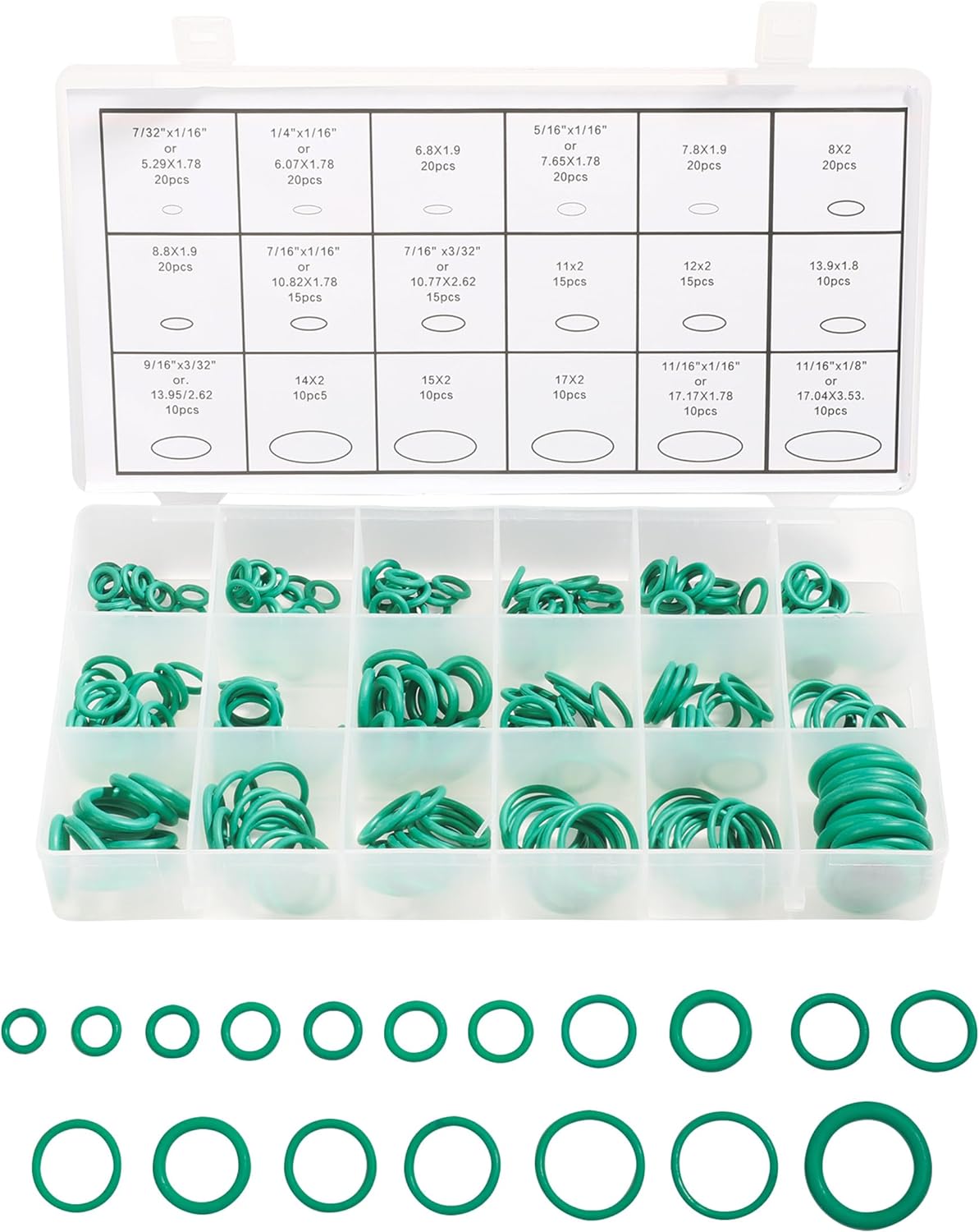

2. If new replacement caps are not available, could I place a new AC o-ring seal (green as shown in photo below) in each cap? If so, do I need to remove the old seals first?

If the caps aren't cracked or broken and the inner seals are intact, chances are you can continue to use them. I had a 1994 Toyota Camry Wagon, bought new, that up until a year ago had the original caps that never leaked.
Take a look at the inner seals using a magnifying glass and a strong light. If you don't see any cracking or worn areas, I'd say that they are still good. While you have the caps off, put a small dab of Nylog Blue (available from ACKits.com, this Forum's sponsor) on each internal seal and the sealing edge and threads of each service port before screwing the caps back on.
And yes, each cap is the primary seal, and each Schrader valve is the secondary seal, just the opposite of what most people think. The original internal cap seals usually have a square configuration while an o-ring is round, so I wouldn't replace the seals with o-rings over concern that the o-rings might leak.

I've encountered just a few service valve caps that leaked. One was on a R-12 refrigerator from the late 1960s that lost its charge due to a crack in the seal of the service valve cap (like with vehicles, never expect a service valve schraeder to seal 100%). And a couple of years ago one of the valve caps on my R-12 1988 Mazda truck leaked, but since it still contained about 1/2 charge of R-12, I didn't change that service valve, just the cap (I don't have the tool to change the valves without losing charge).
When I visited the local parts yard a decade ago, I grabbed quite a few R-12 and R134a service valve caps, some like in your photo.

Primary seal? I find the comment laughable but understand the point people are trying to make. Think about it, a service port w/o a Schrader and just a cap. LOL You need both for the best chance for no leaks.

I purchased a couple of new caps at NAPA today. I'm guessing they should be installed until they are snug, and then tighten just a bit more. But maybe someone can let me know how much force is needed when installing the caps in order to avoid refrigerant escaping.

The caps are usually plastic, so don't over-tighten them. No wrench or pliers needed. Finger-tight is sufficient after lubing the inside of the caps and the exterior of the service ports with a light coat of Nylog Blue or PAG oil.GJHANS wrote: Tue May 07, 2024 7:28 pm I purchased a couple of new caps at NAPA today. I'm guessing they should be installed until they are snug, and then tighten just a bit more. But maybe someone can let me know how much force is needed when installing the caps in order to avoid refrigerant escaping.
