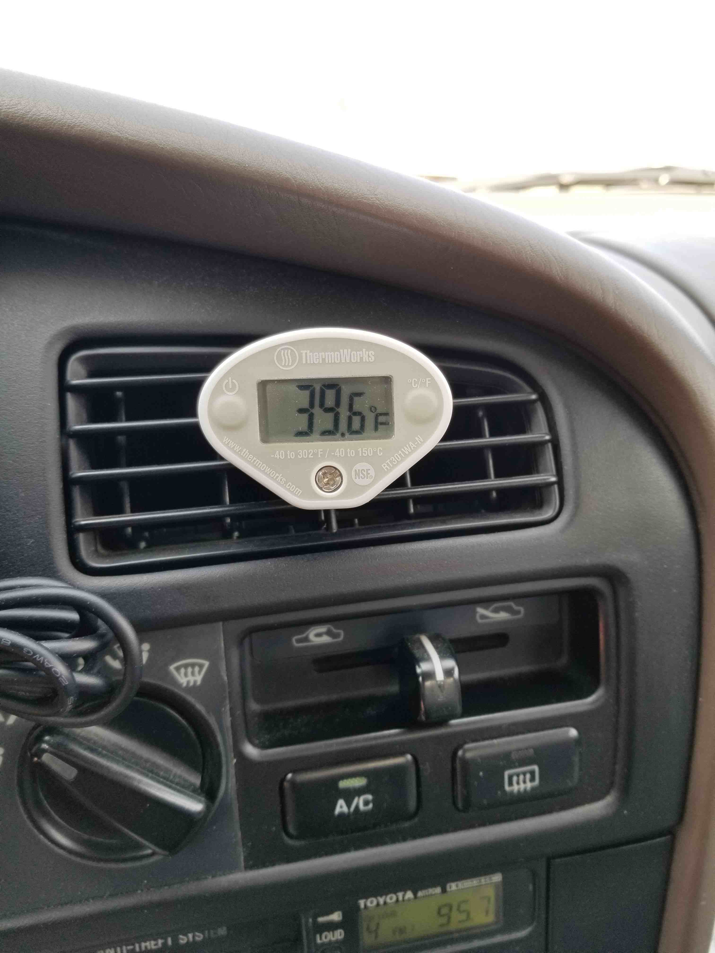

Posts: 1847
Re: Leave well enough alone or charge AC system? Older Hondas
Place a thermometer in the center vent and keep it there so that you can monitor A/C performance as you drive. Should temperatures rise into the uncomfortable range, you'll know immediately that you have a problem, verified by the thermometer.
