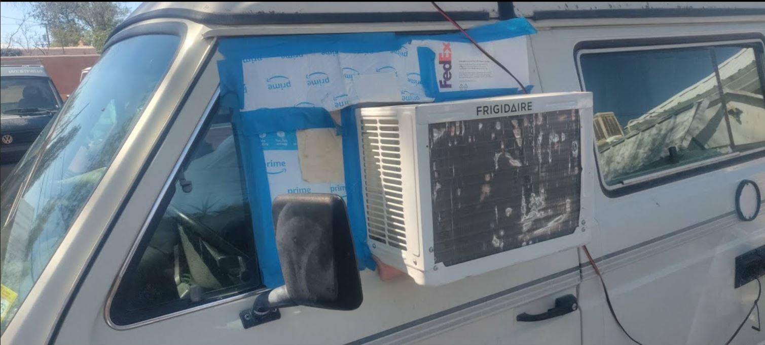

Yes, insulation would help. Issues are:bohica2xo wrote: Mon Aug 28, 2023 6:28 pm A better investment would be high efficiency insulation for the van, and a creative bracket to mount a small 110v window unit in a doorway or window when stopped.
1) a lot of window area
2) insulation in body panels has the catch-22 of insulation vs. condensation being retained by insulation causing interior panel rust.
3) inside the body panels there is mechanicals that run or I, personally, like to find ways to use them for storage.
Below is a pic of a temp solution I’ve tried (and others with vans do this successfully). It is a 6k BTU (maybe 8k? I’ll check) unit so if the 12V is close to 12k BTU, it would certainly be sufficient. This unit is good to about 100 on a van that was sitting in the hot afternoon sun. Also works with higher ambient in started before the heat of the afternoon. (somewhere on here y’all talk of ?retained? heat of parking in the full sun and then having to cool the vehicle including all the thermal mass of the seats, interior, etc. down from 160Fbohica2xo wrote: Mon Aug 28, 2023 6:28 pm and a creative bracket to mount a small 110v window unit in a doorway or window when stopped.
The biggest issue with a window unit like this, and thus the biggest advantage of the in-line 12V unit is storage, that the window unit has to be toted, stored, and set-up where as the in-line unit would be a switch to turn on and would just be siting somewhere hidden away.
