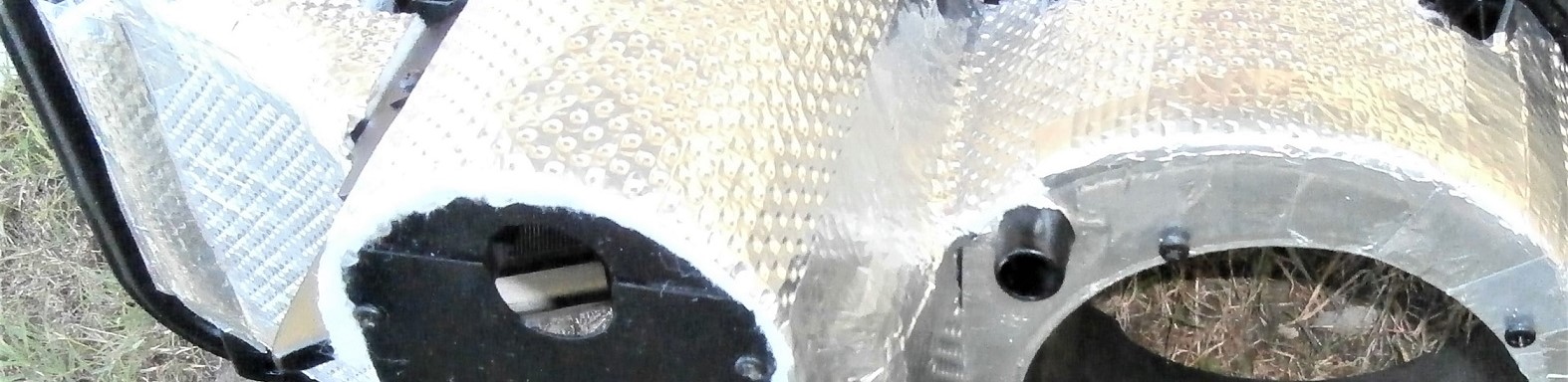

Picture showing GM RHdrive evap box
large hole blower fan ,,small tube blower fan cooling tube
medium hole evap box suction line exit
Sticky fibre glass insulation aluminium coated top /bottom /sides
NB CAUTION some insulation is cheap foam and very thin foil. This is fibreglass insulation with good durable layer of alloy sheet
Its so sticky u cannot re-position pieces , u just cut a new piece
- Right hand drive GM evap box
- P9170179 [4] (2).jpg (192.86 KiB) Viewed 10347 times
