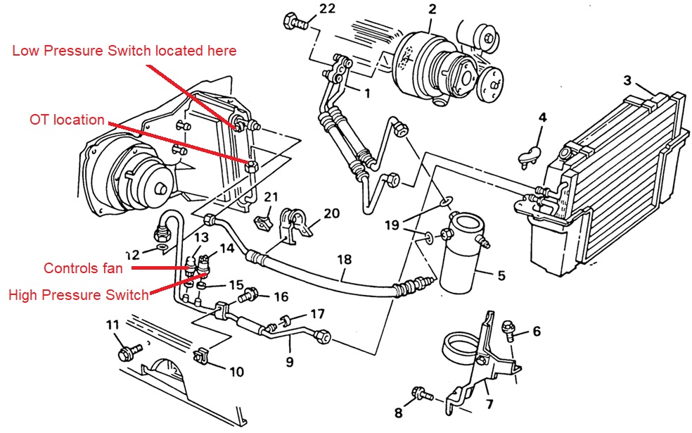

When you mention the switch on the accumulator will take care of everything, if it has been wired correctly.
This is what I have as it came from factory:
Kenny
The diagram is most useful.
OK, so the LPCO is not mounted on the accumulator, but on the low side line as it exits the evap. Basically the same idea. Do not think I have seen modern adjustable LPCO switches. I agree with John that adjusting it prolly was not necessary, especially since they are usually fixed. I guess you will be OK, but be aware of the cautions he gave you, ie, evap icing
