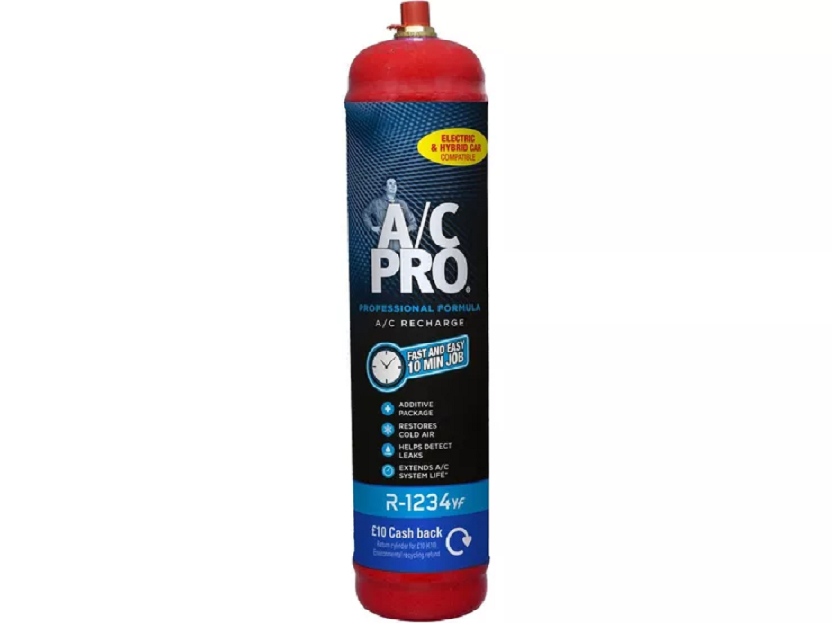

I've owned the car for 2.5 yrs now and the air con has always been poor in the back of the vehicle. I topped it up 2 years ago not long after I bought the car. Both times I have used the same product. (Shown Below)
https://www.halfords.com/motoring/engin ... 12110.html
Re: Poor A/C in rear of car
I would be leary of that product. It states it has an additive package, but does not specify what that is. Sealers are to be avoided.
Perhaps the labeling on the back side explains in more detail, if you could get a close-up of the can you used.
I am not able to bring that product up on any USA sites or even on Google

I do not have the bottle now. There was £10 cash back on it and as it took the whole bottle to top up the air con I took the empty bottle back for the refund.
Pretty sure they contain the coolant and oil to top up.
Any way to go back to that store and take a pic of the ingredients...closeup...

maverick54 wrote: Mon Jul 11, 2022 9:33 pm I do not have the bottle now. There was £10 cash back on it and as it took the whole bottle to top up the air con I took the empty bottle back for the refund. Pretty sure they contain the coolant and oil to top up.
There was no way to know whether the system needed any refrigerant and oil at all, and it's virtually impossible to "top up" a system to the proper amount. We don't know the operating pressures, but it could be grossly overcharged now since you installed the entire can of product. But that's only a guess. A certain procedure must be followed to correctly re-charge a system as another consultant alluded to above. Unfortunately, those "death kits" as they're known in the trade don't allow consumers to do so. Many professionals believe that those kits should be taken off the market.
