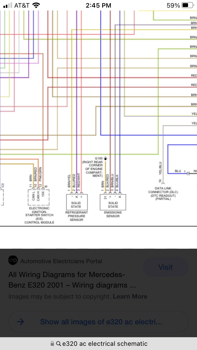

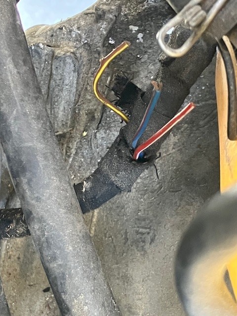

Well I found the schemaic for the pressure switch and upon closer inspection I found the 3 cut wires. Now need to get or make a connector and determine which wire goes to which terminal.
- pressure switch.jpg (132.23 KiB) Viewed 6710 times

Could be. Tracing them on the wiring schematic should lead you to the correct connection points.erubin wrote: Tue Jul 05, 2022 1:56 pm The second photo is taken from above. The electrical connector for the RD mounted temperature switch is intact but the RD mounted Blade type; 3-prong electrical connector is missing. I do se two sets of wires dangling in there, one is a green and a brown wire and the other severed wire pair is red/white and blue/brown stripped. Maybe I need to keep looking for the pressure switch 3-wire if it's not these?
