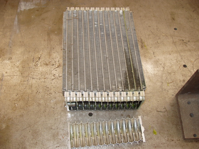

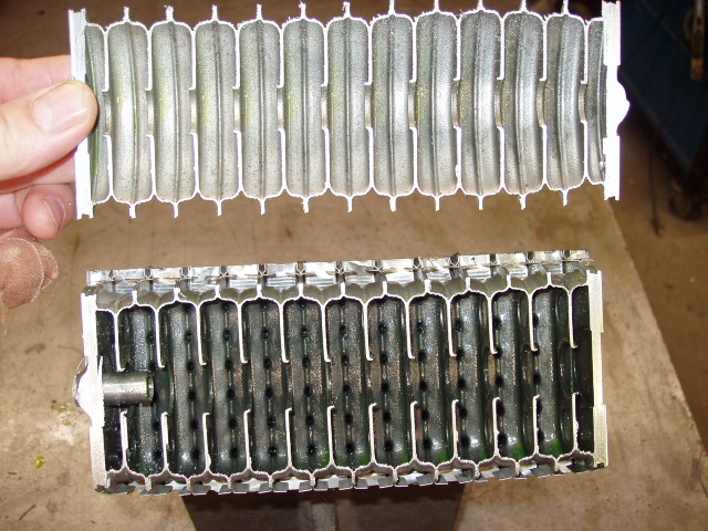

Any chance we can get a pic of the guts of the old evap....
Re: 1988 Chevy Suburban r12-r134a retrofit problems
Sounds like you are just starving most of the evaporator, either undercharged or the OT is too small, is the evaporator an aftermarket? If you could link us to a picture of the evap so we can see how it's circuited?

Here are a couple of PICS of the original evaporator. The one I replaced it with is a Fourseasons 54275.
If its under charged and starving the evaporator would the over all temp of the evaporator just be warmer and not have a 22* difference from one side to the other? It also seem like the path of least resistance for the refrigerant to flow would be on the left side of the evaporator not the right where it seems to be flowing ,or is the velocity high enough that the majority of the flow it getting to the right side where it can only do a 90 degree turn and go up or do a 180 to get back to the warmer passages? I trust your opinions on this way more than my little bit of experience and the pressures do seem a little low so I am happy to add some refrigerant and see if this temp difference goes away. How does one determine if the orifice tube is too small?

- P1010035.JPG (147.4 KiB) Viewed 20521 times

Here is another PIC showing the inside a little better. For some reason I could not attach both images in one message.
- inner passage layout
- P1010034.JPG (148.21 KiB) Viewed 20521 times

Single pass evap, I never worked on stuff that old, would not have guessed it. They are not great at any loads, but there is also not much that can go wrong.
What size, color orifice tube are you using? Is this a front only system?
