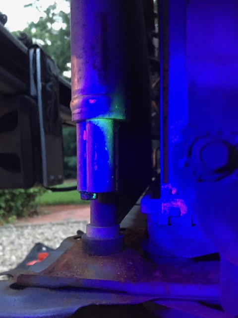

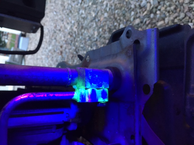

Thinking that I had a leak, I pulled front fascia off car to better shine my UV light (already had this in my arsenal of tools) and discovered leaks at lower condenser connections (one at receiver / dryer) and one at output line connection. See photos of florescent dye tracks. No other leaks were detected -- none on lines, none at compressor, none at ports, none anywhere else on condenser including fins and none at drip tube of evaporator or water droplets from evaporator). So I bought a can of pure r134a (no additives) and a set of yellow jacket manifold gauges/hoses.

Fix the leaks first.
Sounds like it could be a low-charge condition caused by the leaks, as mentioned, but also just a tired little scroll compressor (which is what I believe it has) after around 12 years despite the low mileage.

You are wasting your time unless the leaks are fixed.
You have a known proper charge amount for your vehicle, that is exactly how much you need to charge with using your good scale. Most of the refrigerant mass exists as a liquid, so you can think of the charge amount as being a measurement of the liquid line and receiver internal volume plus the operating liquid in a bubbly mixture of the condenser and to a lesser degree the evaporator. The charge level on your under hood sticker is to be taken as the truth, the whole truth, so help me god.
