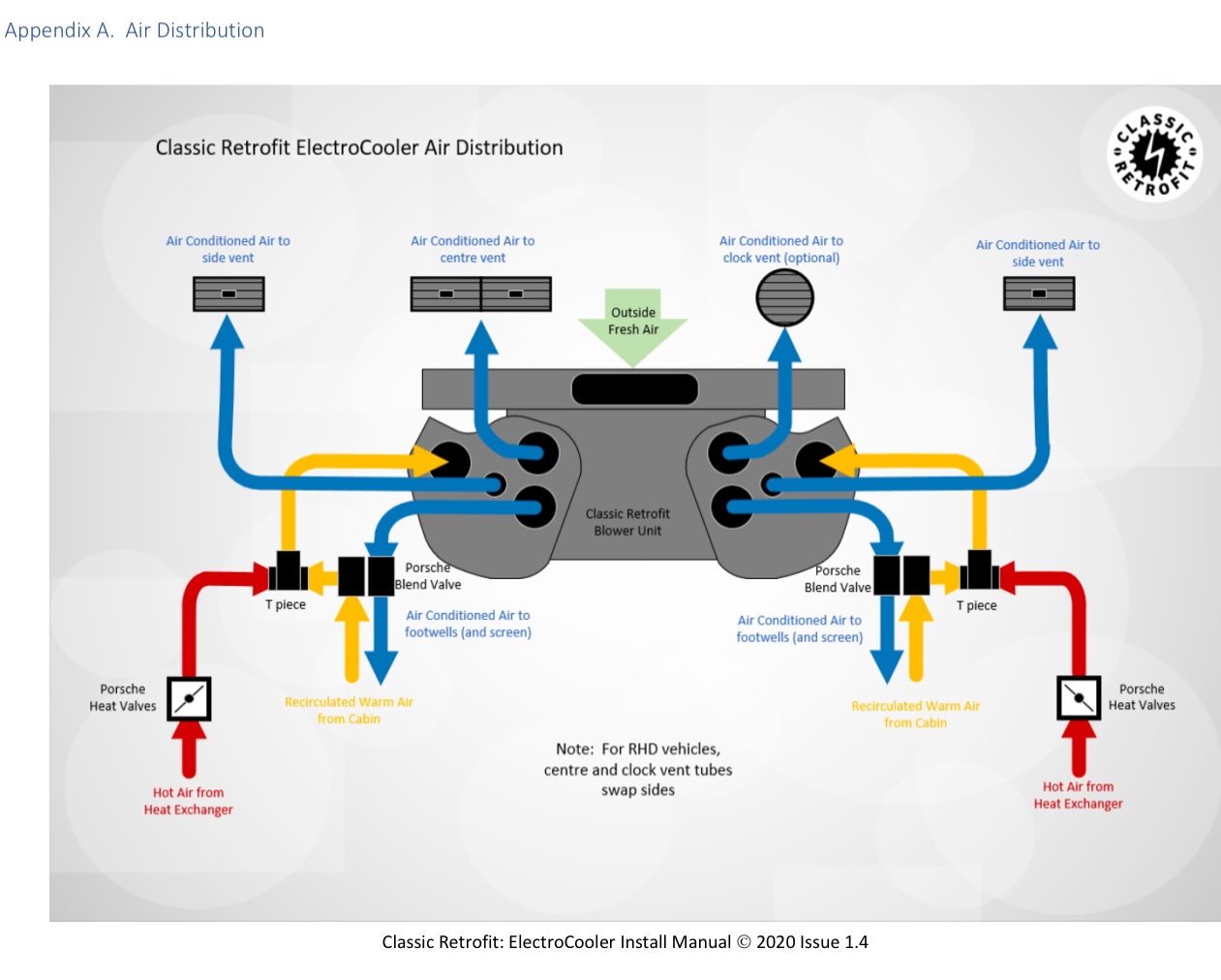

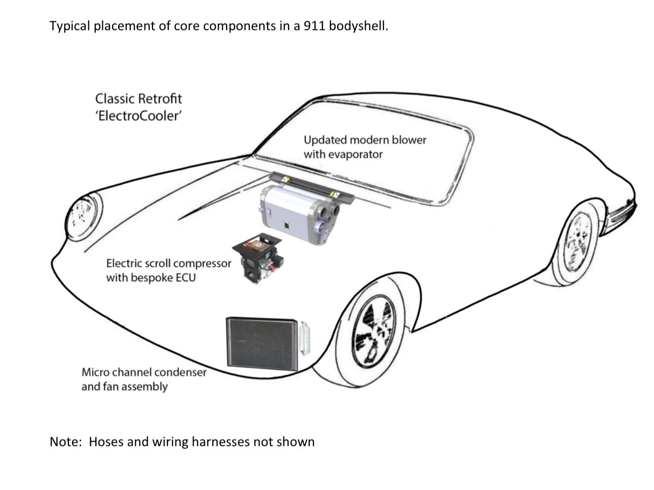

Thank you again. The attraction of this kit is the electric compressor. As you can see below the evaporator and blower are packaged together. So the evaporator only intakes air from the front compartment if not plumbed to cabin. The front compartment is poorly sealed to cabin but is space I don’t want conditioned. This setup is pretty standard for older Porsches—-condensers in wheel wells, distribution crammed randomly around stuff behind dash. My car, a 1968 911, will get an upgrade to a 175 amp alternator. The concern to me, and from what I see of others just following the install instructions , is controllability and air intake/outtake for the blower. We are being told that the system is set for 30% fresh air. I asked why. Crickets. Everyone tells me you must have conditioned air in the foot wells (the blowing air makes your knees and you feel cooler). And as I’ve said, one opening with concentric hoses takes air for recirc and blows air into cabin onto knees. This whole thing is controlled by an on off button. Ok, so I want fresh access but only when I want it thru the system (aspirational). I agree with people here that you can run recirc all the time. (Engine in rear;). I can’t understand why precious conditioned air must be sent to knees. If I can modulate or turn off compressor then I can either run all fresh air or tone down the amount of conditioned air. I think this is correct as I understand modern pulley driven compressors cycle. I may be missing something here. The one thing I don’t know about is modern flap valves that may be required or how to safely cycle the compressor (system) to have more control.

Oh, and I understand the system may not have capacity. But I realize I can’t jump in the car, run errands, and expect the system to keep up. Porsche’s have too much glass. But hey it is something. Bill

Why 30% fresh air?
Well, it is an air cooled car with a heating system that includes heat exchangers on the exhaust system. I have owned a few air cooled cars, and many times if something was not right in the heating system you could smell the engine compartment. In the worst case you get pumped in Carbon Monoxide.
VW and Porsche cars of that vintage leak air / take in fresh air in the front of the cabin. It was the manufacturer's way of covering their butt.
I can't tell you why they are so worried about the footwell air. Turn it off if you wish. Picking up the cabin return air from the footwell should cause enough flow in that direction to cool your lower extremities anyway.
Make sure the heater valves shut off all the way regardless of anything else you do. If you elect to make it 100% recirculating please open a window a bit in the winter months.
