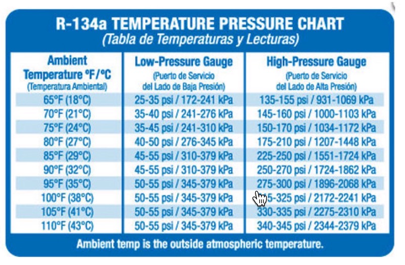

According to the ambient T/P chart the car seems off on the published numbers. Thats not to say that those numbers are correct and are maybe just ball park numbers. I was an HVAC tech for 15 years but that was over 30 years ago in the days of ambient +30 for R22 systems. I know next to nothing about R134a auto systems. It just seems that the vent temp should be colder than it is. But maybe I'm wrong.
Here are my numbers that I came up with that netted me the lowest vent temp.

Heres the ambient T/P chart that I found online for R143a

In your second test at 1800-2000 RPM, the low-side pressure looks good but the high side is somewhat elevated. It should be around 200-220 at that ambient. Did you still have the same auxiliary fan blowing through the grille or just the vehicle's fan? If the latter, you might have an airflow, fan, and condensing issue.
That being said, with a low side of 30 PSI, I would expect to see a center vent temp in the low 40's. So I agree with the previous comment that you might also have a reheat issue.
