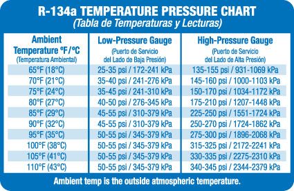

Tbirdtbird, I started using this chart (see attachment) as reference for gauge pressures...what do you think?

I would sideline that chart. The lo side numbers are way too high for the higher ambient temps and would result in very little cooling. Regardless of all other factors, we like to see a lo side about 30-35, certainly never over 40 regardless of ambient. And this is Texas, think we see high ambients...
Recall that your lo side psi is nearly equal to the temp at the evap. You lose 5 degrees of cooling (ie a rise in vent temp of 5 degrees) from the moment the air rushes past the evap fins and splashes out of the vent. So a lo of 40 psi equates to a coil temp of about 40F and thus a vent temp of about 45F. If you can hit 45F at the vents you have done your job.
So from the chart at 100F ambient, the low could be 55 psi, so the vent temp will be 60F. I doubt anyone would consider that to be actual air conditioning. Cheaper to just open the windows.
In this state I have never seen a properly working auto AC system blow less than 45F, usually more like 40F, no matter the ambient.
As a general rule of thumb, for the hi side, the ambient x 2.2 plus 20% should be about where you want to be. The high side is most definitely keyed into the ambient, way more than the low side.
Some experts here say the high is acceptable if the high is as much as ambient x 2.5 plus 20%. But I would not go over that without looking for a condensing issue or a charge issue.

I agree with the cogent explanation already given. Strive toward getting the low-side pressure into the range it's supposed to be in and forget the chart.
