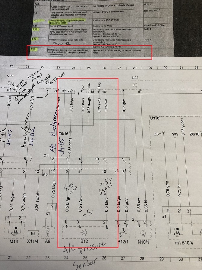

I dug a little deeper into the wiring diagrams and found the test values that confirm my original understanding that this should give a 0-5v output signal.
Now I'm back to believing it's just a bad sensor.

In the photo, I can just barely make out the text that says "1.16, Refrigerant pressure sensor signal input, used to protect A/C compressor when pressure drops," and "A/C pressure sensor, +5V, sens gnd, and 0-5V signal" written in by hand. There's also an electrical symbol that signifies an NPN Transistor in the dashed box labeled "B12."
What all of that is supposed to mean to an MVAC technician I'm not sure. But the device in question seems to control, in a very complicated manner, the "on" and "off" cycling of the compressor to protect it from operating only at low pressures and hence, at reduced oil flow. Apparently, it does this by means of a small signal voltage to the PCM, which in turn switches the compressor on and off.
But why does the signal voltage vary between zero volts and 5 volts? And where does the original "+5V" come from?
According to the photos, the device doesn't appear to turn-off the compressor at a predetermined upper limit to prevent over-pressurization.
It's an esoteric M-B design that I think is unnecessarily complex.

Sorry for the small print; that's the biggest image the forum software would let me upload.
The +5v power supply is coming from pin 7 of the climate control unit (N22)
I just bought a new sensor and tested it - it works! I am getting .45v out of it at room pressure, and a little over 1.1v when I apply shop air to it. That means it should end up being good to 300+ psi by the time it reaches the 5v max signal.
Now that I have a good sensor, since I am doing my own controls, what would be sane values for a minimum and maximum allowable pressure? The compressor is a variable-capacity unit that I'm sending a PWM signal to, if it matters.
