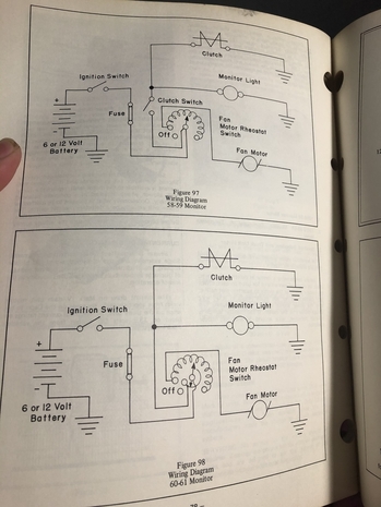

This old Mark IV has no thermostat. I recently bought a service manual for Mark IV ac. I found the wiring diagram. (See pictures) When I look at the temp control it looks like a huge device into the evaporator core without power connected.
I have 2 of these & both have the fan wire connected. (See picture) The only wire loose is the brown wire that’s supposed to go into the clutch fan? How do I wire this thing up? I want to go with a sandon style.
How to wire up old 58-60 evaporator without thermostat???

- BB9663F5-81C3-45FF-BB05-CCF71BB43970.jpeg (125.58 KiB) Viewed 7628 times
- 4B229ADD-ACDC-4273-A588-AC6EDC319BCA.jpeg (110.58 KiB) Viewed 7628 times

I hooked the brown wire up as the fan. Still not sure what runs to to the compressor side.
- Posts: 13
- Joined: Tue Jul 07, 2020 4:11 pm
Re: How to wire up old 58-60 evaporator without thermostat???
I spoke with someone and my hypotheses was right. There is no bulb for temp sensor but it is actually built into the switch itself. I will take apart my parts mark IV soon to look it over.
