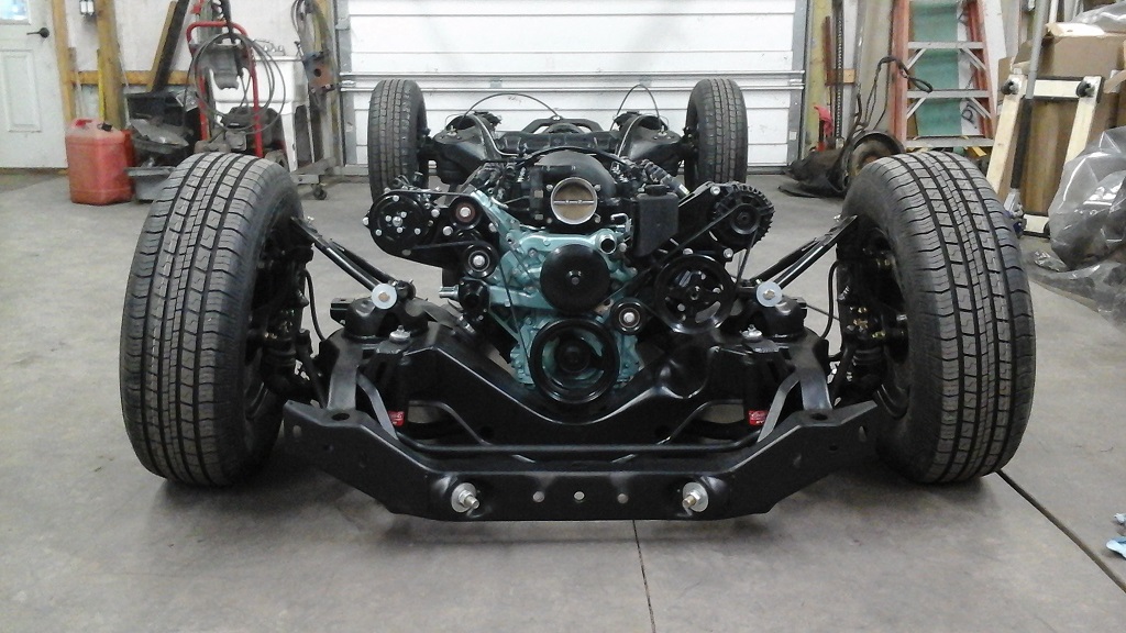

I guess you are using aftermarket brackets for the compressor? Afraid of OEM brackets?
Re: 1961 cadillac conversion
Posted: Sun Jul 05, 2020 1:02 pm
by cadillac matt
attachment]
had to use the holley setup to clear everything and to ad a/c.
