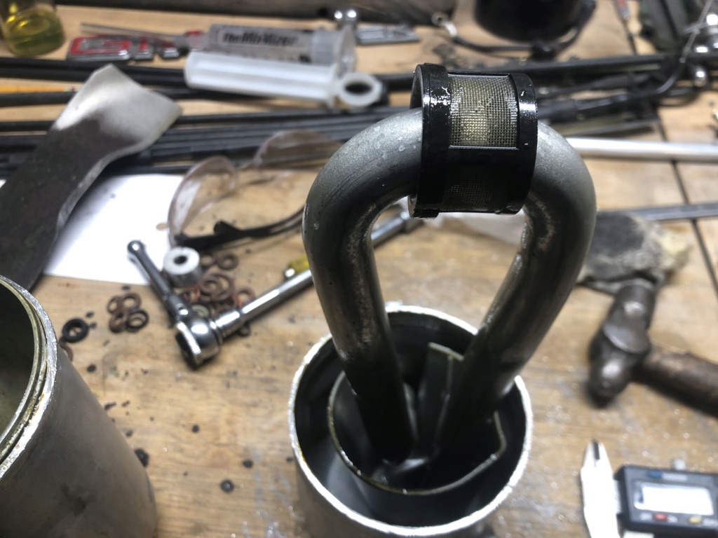

Postby tourmax » Sun May 17, 2020 9:13 am
Cut open the accumulator. Not much to see here and nothing looks out of place.
Top:
Looks all open and (relatively) clean, even the screen over the orifice.
Bottom:
Not much of anything there.
Desiccant bags:
Nothing to see here either. Bags are intact, no desiccant beads anywhere. About all I can say about it is you get black “dust” off the bags if tou try and squeeze the oil out of them.
So, condenser clear. Accumulator clear. Blew air through the evap core and no noticed restrictions.
Why is this not working? Why is it not cooling? About all I have left is the compressor. I’d rather not take it apart again and risk breaking the carbon seal, but I’m not sure where else to look. Its all just hoses and tubes making up the rest of the system and they’re clear.
