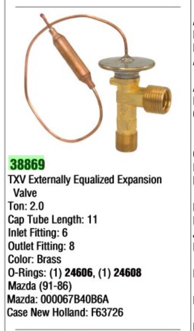

What do you guys think about going with this valve? It is one of the few 2 ton right angle valves I could find in catalog. It is also internally equalized and reverse flow (so the orientation will be the same) but the fitting sizes are different. I will have to weld on the appropriate fittings to my lines to attach to this valve.
The lines in my care are male insert o ring with the inlet being M16x1.5 and the outlet being M22x1.5. I cant find any 2 ton valves with these fittings.
The reason I would want to go with 2 ton instead of 1.5 ton is since I am trying to get the fastest cooling possible I want the valve to be able to flow enough refrigerant on initial startup when the valve is wide open (high heat load).
https://www.4s.com/en/ecatalog?partdetail=38869&view=bg
Tim I am not sure if you'd be able to find an alternate source for this same spec valve? Id rather not buy a four seasons product if it can be avoided :). This valve appears to be for an early 90s Mazda.
