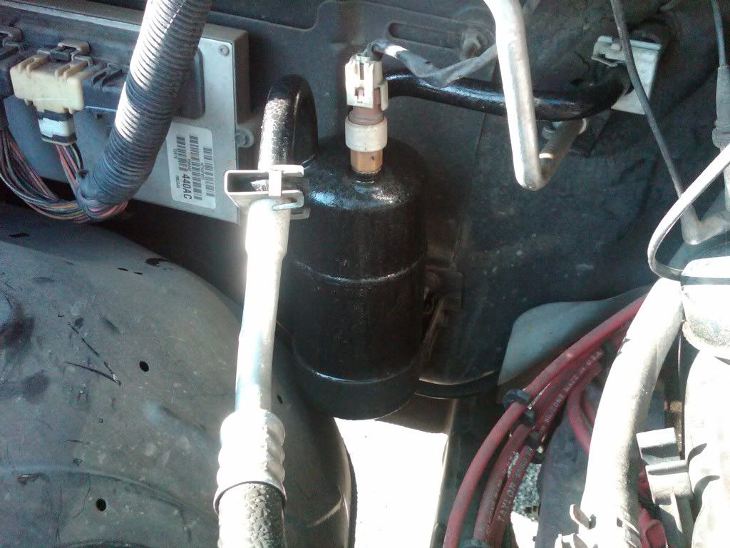

I wanted to make sure I could get all the spring lock fittings disconnected before I ordered some parts. I got a disconnect tool set from AutoZone spring lock fitting tool from AutoZone I was able to get all the connections loose except for the one that connects the accumulator to the line from the evaporator. It's right up against the firewall, and up against the bottom of the cowling, so there's poor access.
Is there a trick to get stubborn connections loose? I didn't want to wrench on it too hard and cause a problem with the evaporator. This job is going to be expensive enough already without having to tear the dash apart.

Jag987 on Sun May 18, 2014 7:47 PM User is offline
I know that fitting well. I did a recharge only for a customer last year on a truck about the same year. I couple of hours latter, I could hear it leaking. I went looking for the leak and that line blew off as soon as I touched it. With the limited space, I have found that sometimes a little, cheap disconnect tool like this works better.
Be careful and give it a good tug when putting to back together. This held fine under vacuum and appeared fine right after it was charged, but would have blown as soon as they drove off.

I was considering that tool as well, but my local store didn't have that style. I'm pretty sure the tool I used got in there good and released the spring ( I could feel it release like it did on the others) but it wouldn't pop loose. Any thoughts on cutting the accumulator line before it connects with the evaporator line? Here's how the parts are layed out

zzyzzx on Mon May 19, 2014 10:20 AM User is offlineView users profile
I use these:
http://www.harborfreight.com/4-piece-a-c-fuel-line-disconnect-set-98118.html
zzyzzx on Mon May 19, 2014 10:21 AM User is offlineView users profile
One I have released the spring, if it does not come right out, I turn the like back and forth until it does.
Dougflas on Mon May 19, 2014 3:16 PM User is offline
If the line won't come apart and you're ssure the spring is released, try heat from a heat gun or a good hair dryer. As long as you plan to flush it, try a solvent on the connection. You're correct, they can be a bear to separate.
