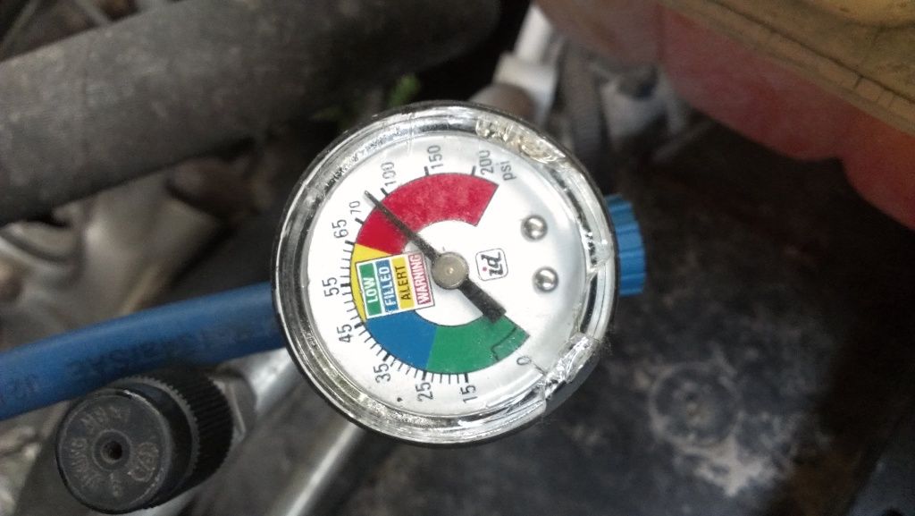

Ok first off last year I replaced just about every component in my ac system because I assumed my compressor was gone, but anyway on to my current problem. I have tried and tried to fix my ac system but I cant seem to get rid of this noise and now it doesnt even blow cold anymore. I was only able to use a gauge that came with the refrigerant to maybe give you all an idea of what my truck is doing. Below you will find some media hopefully someone can help me out. All help and advice will be greatly appreciated.
Ok here is a reading with my truck off:
