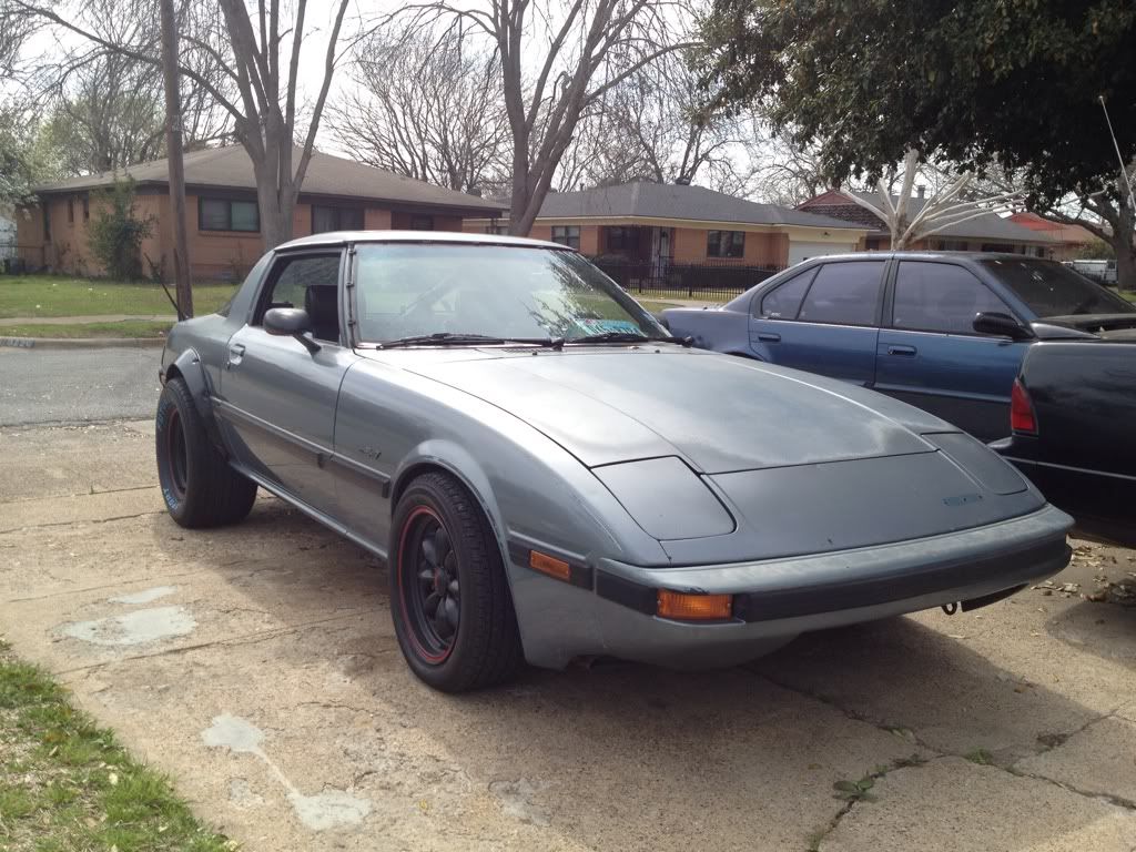

James89dx on Sat April 21, 2012 3:11 PM User is offline
Slightly off-topic but I take it you must be lsX swapped?
My brother and I just finished an ls1 swap on his 1st gen:
No A/C in it though so I can't help ya much
Edited: Sat April 21, 2012 at 3:11 PM by James89dx
