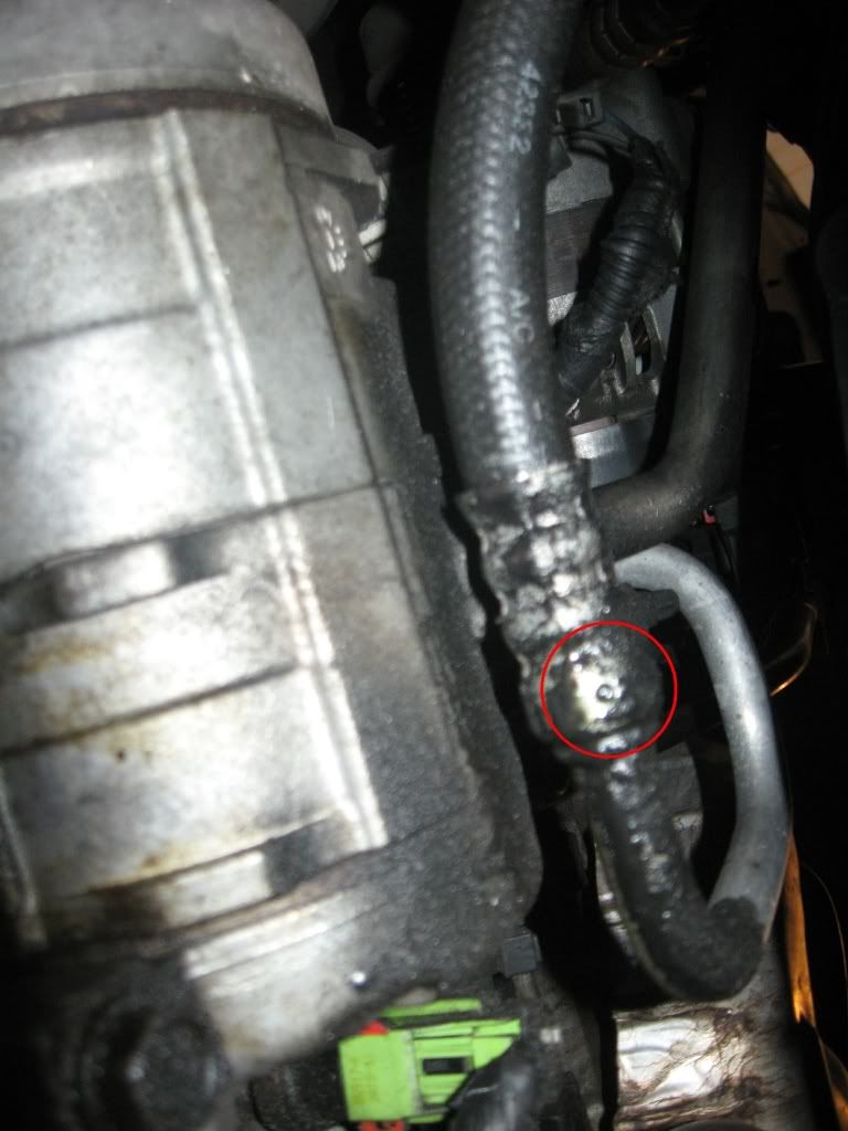

ajhoward on Sat December 03, 2011 7:48 PM User is offline
I checked it out the compressor is engaging both hot and cold, but I think I found the culprit. I can see a leak near the compressor that was bubbling after it heated up.
