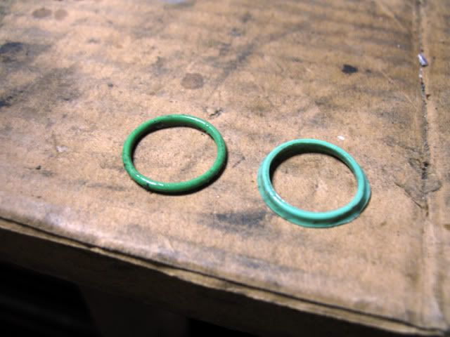

My 134a conversion went well with the exception of a slow leak that surfaced after three weeks of buttoning up the system. I used an SPX/Robinair Electronic Leak Detector and traced the leak to the evaporator side of the accumulator. When I removed the accumulator, I found found the leaking side had a funky kind of o-ring on the fitting. It's the deformed o-ring on the right in the photo below.
The o-ring feels more like a hard plastic ring rather than a "rubber" ring like the o-ring shown on the left. I don't recall noticing this difference in o-ring material when I re-assembled the system
After replacing the o-rings and accumulator, I partially charged the system and sniffed around with leak detector again. I still detected a leak at that location. After some trial and error, I stared to detect leaks at every threaded connection in the system if I left the detector probe in position after 30 seconds or so. This was the first time that I had used Nylog in the threaded fitting and o-rings.
I held the opened container of Nylog under the sniffer and it set off the detector. Is there an issue with electronic leak detection when using Nylog?
The system is working properly again. Hopefully, the leaks detected after assembly are false.
