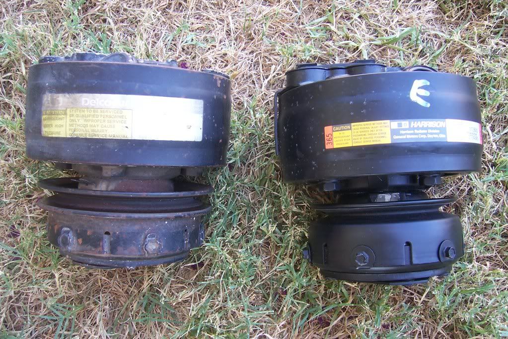

I bought a NEW R4 compressor a couple of years ago and this was to be the weekend that a/c worked for this first time since I have owned the car...nope...

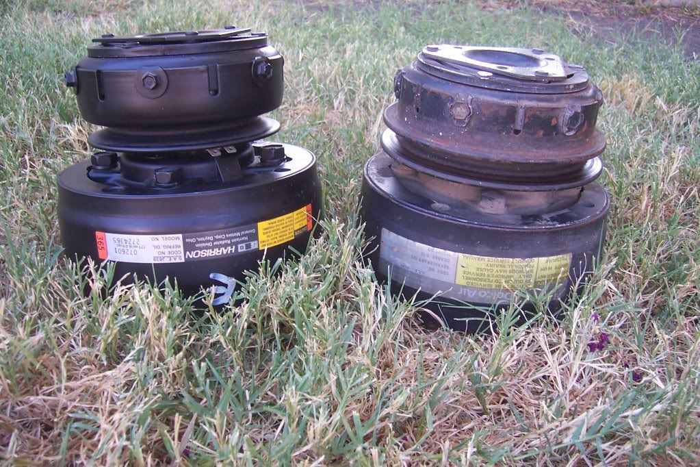

When mounting the new compressor and then pulling it back so that the belt is tight, I noticed that the mounting hole on the comp. is now past the mounting bracket "opening" to mount it. After staring at the back of the compressors for an hour I finally discovered that the front of them is where the problem lies. The rounded pulley part (front) of my old compressor is larger than the new one - so now my new compressor requires more stretch (pull back) to get the belt tight - which throws the mounting hole past the available space in the bracket opening for mounting.
If you look closely there are also some minor subtle differences between the 2 compressors perhaps not worth mentioning.
I am thinking about options to remedy this:
1) Try to find a shorter belt
2) Try to exchange the compresor (pia)
3) Modify the mounting bracket (pia)
Has anyone else ran into this too?

Find a shorter belt. Not that big a deal - even the chain parts stores should have what you need.
The good news is the smaller pulley will increase idle speed output.

If the belt lines up. Get a shorter belt and be done with it. Smaller pulley will make the compressor spin a little faster. But doubt it will be much of an issue.
